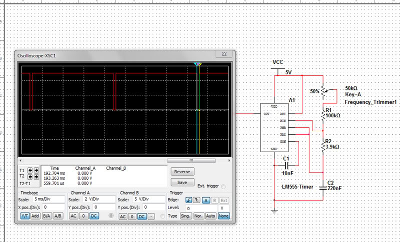

I'd really like to make the 558 work because of simplicity. Here is a screenshot of my astable trigger in Multisim, along with an oscilloscope showing its output: I'm confused as to whether the edge trigger will trigger each time the voltage rises/falls, or just on falling edges?

From the datasheet: "The trigger functions only on the falling edge of the trigger pulse only after previously being high."

I didn't catch that little footnote about the falling edge. Sounds like it's all figured out then. The 'timing' pin which is combined threshold/discharge, and the common control voltage for all timers really makes this chip appeal to me, so I'm glad I can use it. Thanks again!

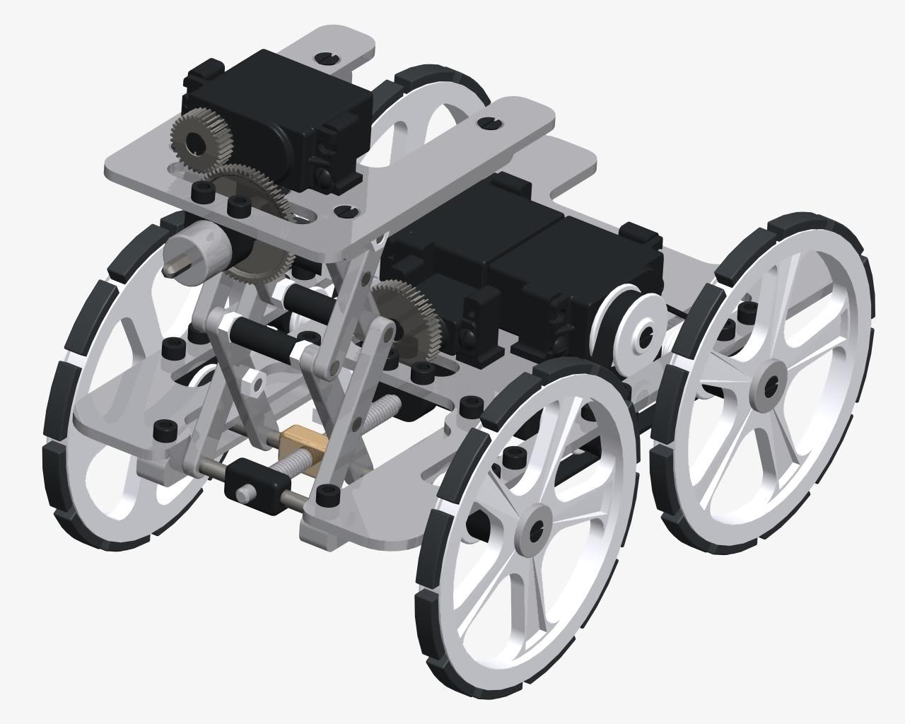

So you can better understand the dilemma, here is a picture of what's going on:
A salvaged RC controller (http://www.futaba-rc.com/radios/futj40.html) will be used to control this robot, however instead of radio waves, signal wires will be connected to the robot instead. I will be installing the 558 circuit and its 9V battery in this controller. Part of the grading includes how many signal wires are used. I still don't understand why I can't accomplish this with only 4 signal wires, one for each servo controlled. I'd really appreciate any help, as time is running out to put the finishing touches on this thing before starting to machine parts.
