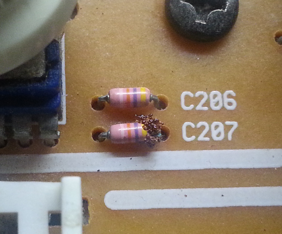

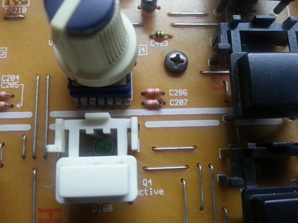

I have a sampler (year of construction: circa 2000) with a broken resistor.

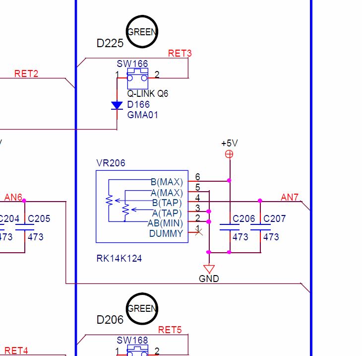

Now I have problems recognizing the colors correctly as well as the tolerance ring. Fortunately I have the service manual of the sampler. But all this tells me about the resistor is the number 473.
After some research I have then found that 473 stands for a 47 kΩ resistor. Unfortunately I am missing the specification of the tolerance.
Can you help me?
Here are some pics:

yellow-violet-orange = 473 = 47*10^3 -> 47kΩ, that's correct.
But: the schematic shows a capacitor, not a resistor. Then the same color code means 47*10^3 pF = 47 nF.
A capacitor at this position is more plausible than a resistor as it will filter the potentiometer's output signal.
Also, for a capacitor a white tolerance band makes sense (it doesn't for a resistor): 10 % (see e.g. here).

Hi Harald,
Thanks for your reply.
So it is a capacitor, great. Now the color code makes sense.
Now I´ll need to find a store that carries this type of capacitor. Since I am a noob at electronics the amount of different capacitors on Mouser, farnell and the likes confuse me.

It's hard to tell what voltage rating is required but it is likely to be fairly small. 10V or anything higher would likely be very safe.

The missing capacitor may result in increased noise...
You don't have to use an an axial type of capacitor. A radial type, which I think is much easier to obtain, will work the same way. Leads can be bent to fit the existing holes or find one with matching pin pitch.

99.99999% of the time their pink body colour identifies it as a capacitor .... just one of those things you learn doing electronics
Ok thanks.
Perhaps the "pink" resistors I've seen were just faded or discolored beige or toupe?
Again, anybody know what kind of cap it is? I assume it's non-polar.

Hey guys,
I just wanted to let you know that I´ve changed the capacitor with this one (
MLCC X7R 47nF 10% 50V RM5,08) and all is well.
Thanks again for your help!
