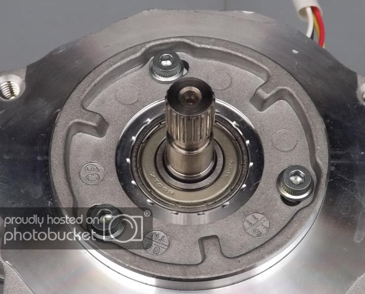

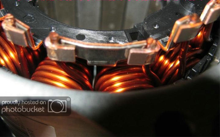

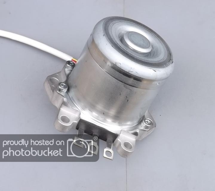

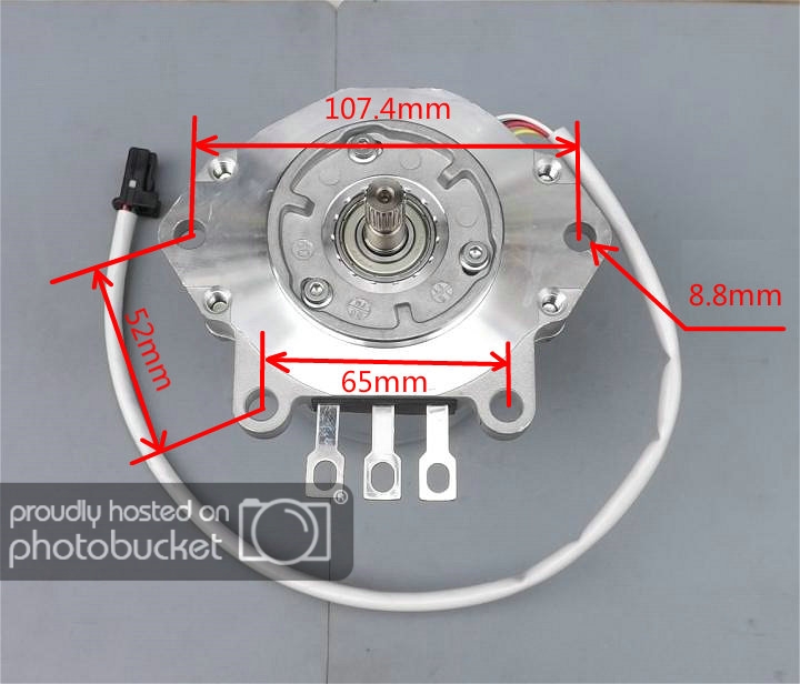

HI Friends, I'm New to THis forum. I need your help , i was thinking to build a Solar Powered water pump project. I found a 12v DC Brushless Motor on aliexpress for 45$ i was thinking to replace it with existing 220v AC water pump water may be its 1Hp or .75HP not confirmed.. but you can get the idea by seeing the pictures..

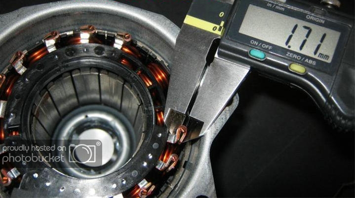

Details of 12v DC Brushless Motor:
RPM = 12v 2400RPM / 24v 4800RPM
Operating Current: Without LOAD 1.5A
Torque 3.5Nm
Coil Diameter: 1.7mm
Here are the Pictures
Replace this Motor against this..
Need your suggestions before investing into it... If we Lower the RPM using Arduino or PWM of 12v DC motor to 1100/900 to something can we get more torque or not?

Not only is the motor unsuitable for this application, they are intended to be ran at much higher rpm's than practical for a pump.
The pump example you show is probably a 3ph 4 pole or even 6 pole induction motor.
M.
