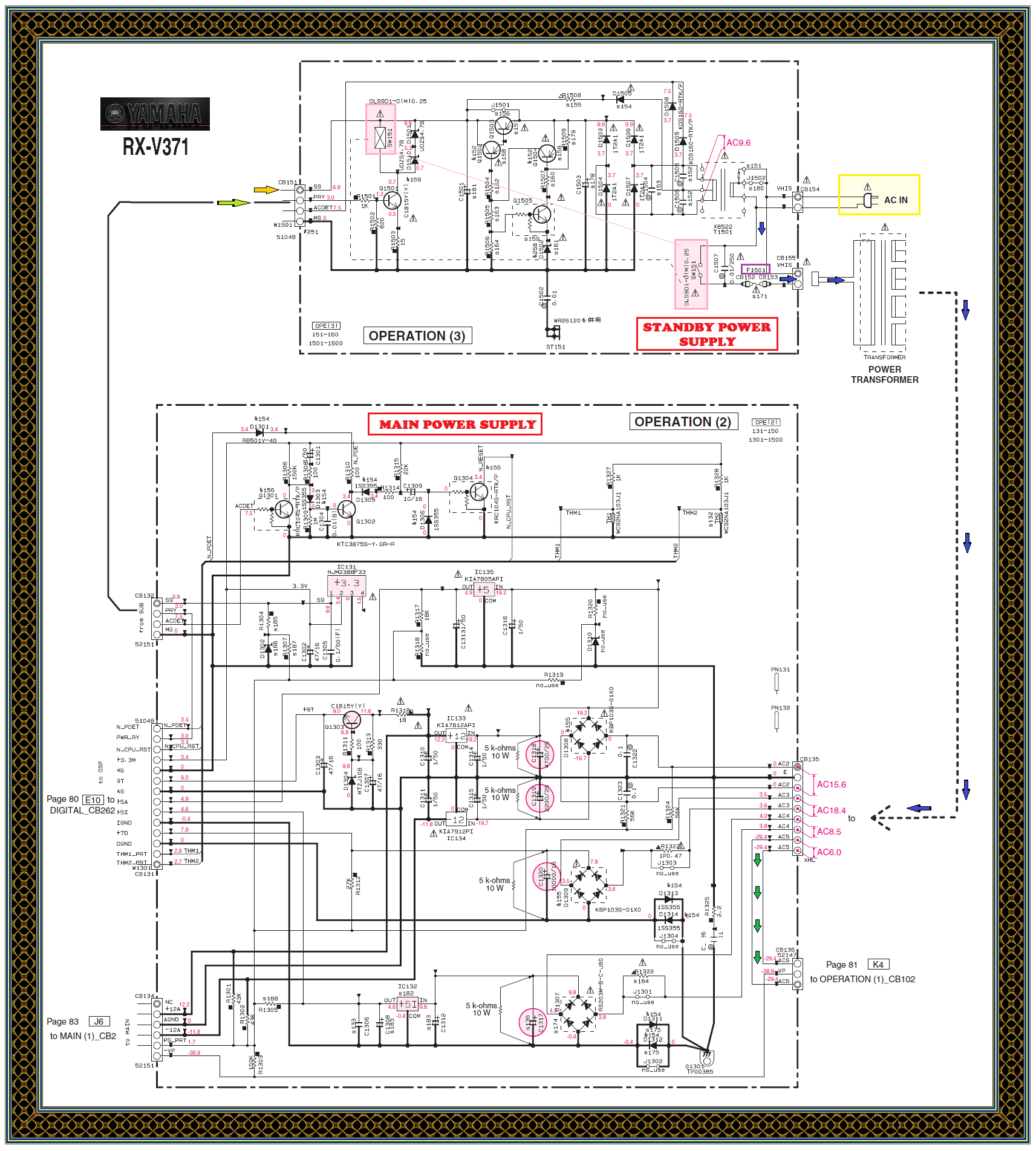

Need Help regarding Yamaha RXV371. No Sound Output

Are those voltage measurements with the connectors fitted or removed? Measure using a proper, designated, 0V point and NOT the chassis (which may well be isolated/earthed)

The connector we fit. Do I need to check the voltages with -ve to MG and connectors removed.
Also is the measurements be done by repeatedly turning the receiver on..or just press the power switch and take the measurement?

Connector OUT. Measure the supplies with respect to 0V (analogue ground where the supplies are stated to be for the analogue circuitry and digital ground where they are otherwise noted)

Sir Hemant Choudhary . . . . .
Oh-tay y y y y y . . . in now starting with YOUR unit of the two YAMAHAULER units at hand.
Here, you have both power supply sections . . . . .which I have now unitized upon one close up page.
The top SBY PS is being continually on . . . 48 hours a day .
INITIAL ANALYSIS . . .of these two supplies . . . .
AC power . . . in at right top corner area and flows to primary of T1501 and it rectifies, regulates and creates the ~10VDC at the ORANGE arrow of CB1151. . . . at far left.
Should you now power on the unit with its switch, the LIME GREEN arrow path should send drive voltage to the base of the Q1501 relay driver transistor to activate the DLS901 power relay, then its switching contacts at the end of the fine PINK line should close and apply AC power to the BLUE arrow line . . .IF PURPLE F1501 fuse is not blown.
The transformers secondary AC windings come into CB135 at the bottom of the BLUE arrow line.
Then the different PINK sections create the + and -12VDC and +9, 7 and +5 VDC supplies, that you see exiting at connectors CB134 and CB135.
The GREEN arrow path is the AC supply for the separate , QUITE hefy, + and - ~30VDC supplies for the POWER amplifier section .
You now want to check all of those voltages to see if they hold on , considering that the DLS901 holds closed.
If so . . . . . that would suggest that the POWER amp section is at fault and going into protection mode and opening the different set of relays, that otherwise, would connect output audio into the speakers.
Sooooooo . . .lets see if this section, and its 2 power supplies are good.
***** Initial observations of your voltage readings at the SBY power output connector, and IF CB132 is being plugged in, is suggesting that pin S9 is unloaded and being high. FIO . . The MG is being a valid ground for metering referencing. Your other AC voltage det voltage is an AC voltage.
Considering that CB132 is plugged in, the relay driver base voltage initially should be there
at power up . . . . . but may drop off . . . which is what we are wanting to find out initially.

Thank You Sir Edd,
As posted earlier, below the the reading on CB151, with all the connectors fit,
MG= 0v
ACDET = 9.8v
PRY = 0v
S9 = 14.6v
When the power switch is pressed, there is a change in the voltage at PRY upto 2.5v but it does not hold long and the goes to 0v as soon as the relay is opened for the second click. ( 1st click for close),
I truly appreciate your effort in making the diagram so easy for me to understand.

Also, the power supply section is "OK" as there are approximate voltages present when the receiver is turned on for the brief moment ( i think so ) but in case, if they are to be tested again, if you guide me i am ready.

OK let's take one quantum jump ahead by seeing that there is being CB3, (Reference page 83) connector, at the main amplifier cable run from the power transformer secondary.
We want to unplug that connector to see if disconnecting that MAIN raw power to the AUDIO amplifiers will result in the standby supply now staying on.

Please close this thread , i was able to complete the repairs..there was a supply voltage problem of the many aupplied that were being fed to the amp and digital ckt.

If it was the loss of the +7 VDC supply it must have been the R1326 fusible resistor, D1309 FWB rectifier pack or the C1320 electrolytic storage capacitor.

Hi,
As per sir Edd notes,
My bridge diode D1309 was heating up and el cap C1320 was shorted.
