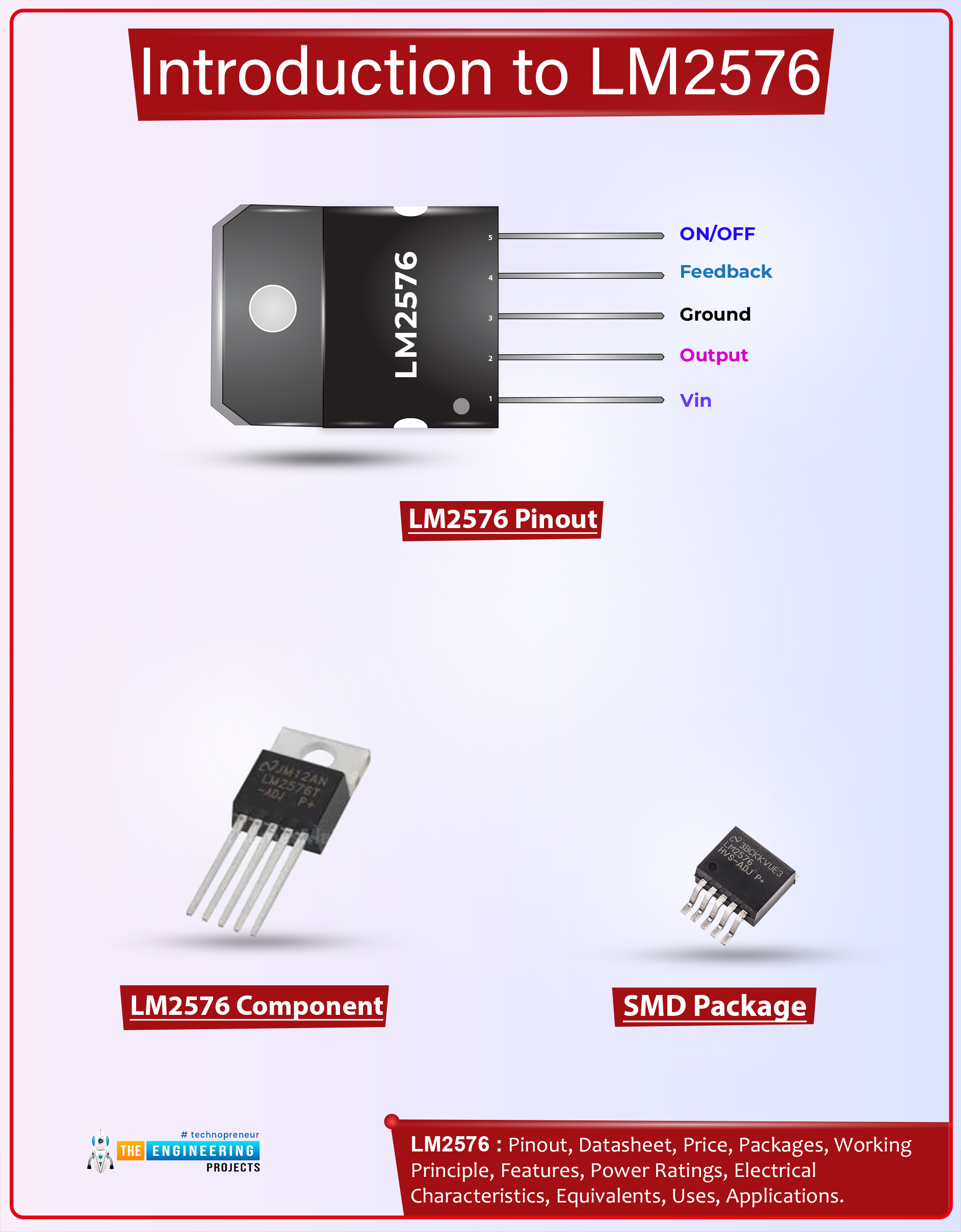

When the AMS1117 module is connected directly to the battery, it continuously draws power, causing battery drain even when the LED is off. Placing it after the touch switch solves the power drain issue but interferes with the dimming function. The AMS1117 has a relatively high quiescent current. Consider using a low quiescent current LDO (Low Dropout Regulator) which would minimize power loss when the LED is off. For example MCP1700.
You can also try a LM2576 Buck Converter instead of AMS1117 to see if your circuit performs better.
