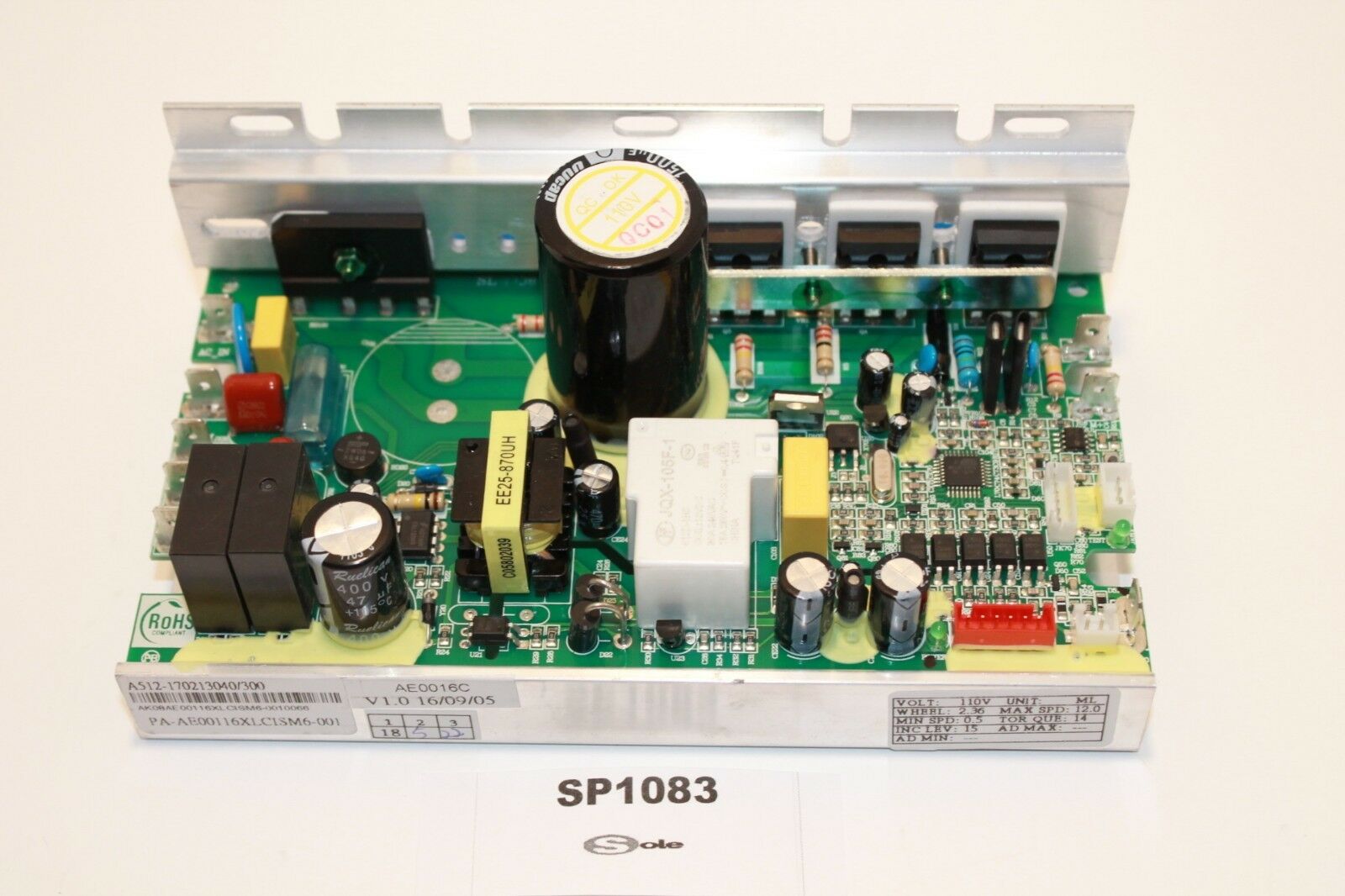

Sole Treadmill Will Not Power Up
Model: F63
Rating: 120Vac, 60 Hz, 12 A
Date Code: 2016, 1Q
Lower Motor Control Board Info:
A512-151128010/1850
BI50AE116XLCISM6-0011558
PA-AE00116XLCISM6-001
AE0016C
V1.0 15/12/29
*Note* My LMCB has a Red colored connection on both the LMCB itself & the wire harness (red connector has 6 wires total) going to the display.
I have tested the Motor while using a 18v DC Battery from a drill. It ran smooth. The Red LED power light on the LMCB it lit up & solid but the display does not work. I can't find any troubleshooting info on the web that's specific to my LMCB. Also the boards with the 6-wire Red connector is double the price as the ones with the 12-wire White connector. Would really appreciate some help troubleshooting this problem. I'm pretty certain the big Cap in the middle of the LMCB needs to be replaced.

In the interim, see if the only unit that I found, that was using one sole RED connector, happens to be your unit.
If so, i can already see some good possibilities showing on it.

73's de Edd The photo of the motor control board you posted is indeed the same one that my unit uses, the only difference that I see between mine and the one you posted. My RED connector actually only has 5 pins sticking up from the LMCB, the very few I have seen online seems to have 6 pins on the Red Connector which would make sense because that main wire harness does indeed have 6 wires. The Red connector was glued in because I had to cut the glue away to be able to remove that Red Connector. The other thing is above the Red connector is a set of 5 square black 4 legged components and my board only has 4. Since I just recently acquired this Treadmill i cannot confirm that this is how it was before and since there is very few for sale online to compare to its hard to say that those 2 things are supposed to be there.

Also I don't know if I said anything about the big Cap in the middle of the board that has a burnt markings or brown discoloration. I have a ESR meter and that is the reason I took the board out of the Treadmill was to test the Caps but that is when I noticed that it wasn't that easy to access the back side of the board. Side Question concerning the Thermal Paste that is used on the Bridge Rectifier and the other 3 components. Would any kind of Thermal Paste due? I have some from replacing my CPU on my Laptop but I couldn't find an answer from googling what is the best Thermal Compound to use in this situation.

That one leg of D24 looks as if heat unsoldered it. And the track has burned. Check for continuity between that leg and the other end where that track goes.
Which leg of D24 are you referring to? The leg closest to the D24 marking or the other end?

The other end, closest to big cap
I checked for continuity from the D24 component from the end closest to the big Cap and I was able to get continuity from there to where the trace led to. So the solder joint must be good. I also checked for continuity. In the main 6 wire harness that goes to the Red connector and every wire tested good. I called Sole Tech Support yesterday and they did absolutely no troubleshooting besides telling me that I should replace the main harness due to the reason its what communicates with the display.

Hmmm. AC side is your house voltage. Not normal
· When I checked the VAC [middle pins] of the Bridge Rectifier it slowly climbed to ~118VAC after I supplied power.
· The outside VDC pins measured 15VDC
· Also tested the LMCB Motor connection pins & measured 62.3VDC
· Also tested each pin of the Red connector on the LMCB with the 6-wire harness unplugged, aslo with it plugged in but then testing @ the end of the 6-wire harness on the Display Console side. I will attach a picture with the readings shortly, both measurements @ LMCB & Display Console were pretty much the same. The results never were steady & all the measurements were taken in VDC W/black test lead on the black/ground of the Red connector/6-wire harness.
