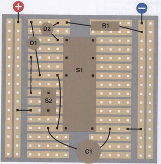

Hello there,
When I put together everything for Experiment 8 in Make Electronics and connected a 12v power supply, the LEDs blinked at the same time when I held down the pushbutton.
Have a few pictures:
My power supply.
The relay.
The circuitry
Now, here are the details:
The relay clicked every time the LEDs turned on.
Both LED's blink at the same time (one LED should turn on when the other is off).
The LEDs on the dim out after turning on.
The relay appears to function like the relay used in the book (p. 59).
I've checked many times to see if I've wired my circuit correctly, and it seems I have (but just in case, assume I haven't checked in case I've missed something).

"LEDs will alternate at a high enough rate to both appear to be lit simultaneously, but dim" I used a 1000μ capacitor, and I can see the LEDs dim for half a second before returning to full brightness
Thanks KJ6EAD for supplying the schematics for me. "mkel_02_066.pdf" is the schematic I've breadboarded.
"I assume that the LEDs are suppose to* go to different contacts of the relay, one normally open, the other normally closed, so you have a changeover contact arrangement (this will ensure only one LED is on at a time)."
Both LEDs are connected so that they share the negative power supply from the resistor and one is connected to the normally closed terminal and the other is connected to the normally open terminal. Both terminals lead to the positive end of the power supply.
It could be the way my cheap multimeter is, but the relay coil had a resistance of around 750Ω where as another latching (latching relays wouldn't work with this circuit, right?) relay had a resistance of around 150Ω.
Does the resistance of the relay coil make a difference?
Here is the data sheet for the relay: http://www.datasheetlib.com/datasheet/453231/hfd27-012-h_hongfa.html#datasheet
S1: Relay
S2: Pushbutton
D1, D2: LEDs
R1: Resistor (680Ω).
C1: Capacitor (1000μf)

Your relay has a non-standard pinout, different from the relay used for that breadboard layout drawing. On your relay, the changeover contact (which connects to the pushbutton) is on the third pin down, and the normally closed contact is on the second pin down. So you have to swap the connections to the second and third pins, counting downwards from the top.
To be exact:
  • The top end of the link wire just below D1 needs to move downwards by two rows, so it connects to the third pin on the relay, not the second;
  • The bottom lead of D1 and the top end of the link just to the right of S2 both need to be moved upwards by two rows, so they connect to the second pin on the relay, not the third.

Alright! the circuit works now! Thanks so much, I've spent so many hours working on this, and now it works!
Just one question, the left hand LED (D1) only stays on for a very brief time. D2 stays on the whole time the button is held down, then when the relay clicks, D1 turns on for the duration of the click of the relay (an extremely brief flash). Is there a way to make D1 stay on longer?
