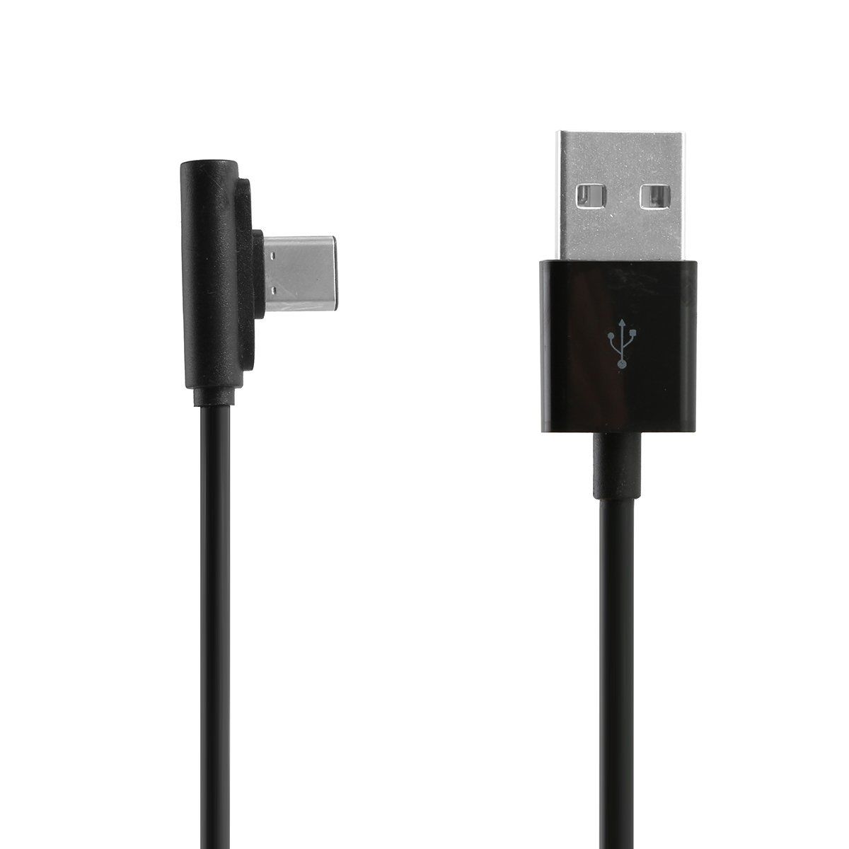

Anyway I'd get a couple of these and start carving on one to see how much material can be removed:
https://www.ebay.com/itm/90-Degree-...ast-Data-Sync-Charger-Cable-Cord/232753983444
