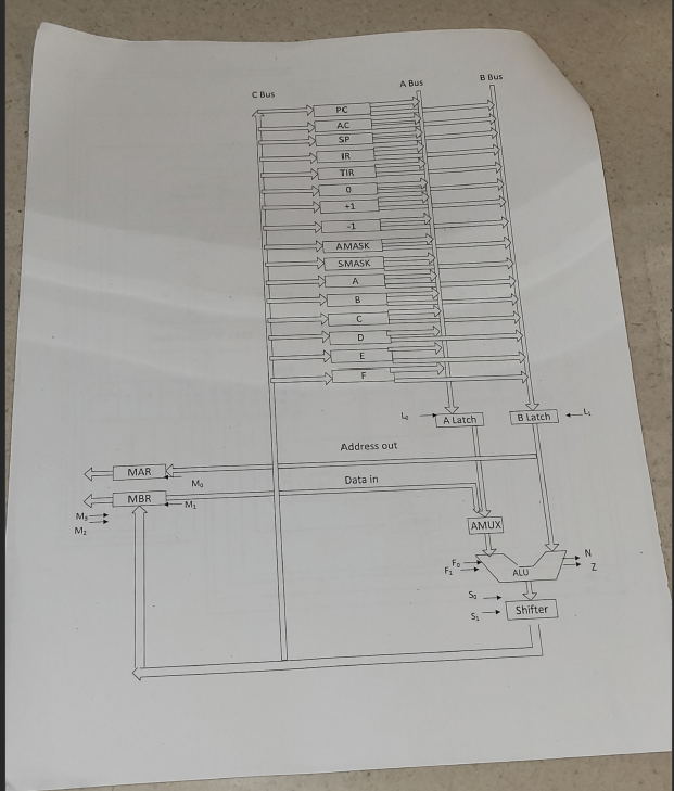

It appears to be just an exercise of going through each step, one by one and assigning the correct values to route the right registers to the ALU and back to the correct registers. Just as in any problem for setting digital muxes as in creating microcode to do operations.
Not trivialising your problem, just saying; follow the steps, it is likely to work and not take too long.
PC<<--- PC+1. I'd guess you set the mux values to route the PC to the ALU, to also route a "1" to the ALU and to route the result back to the PC.
