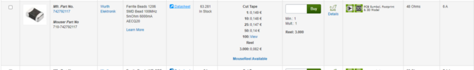

But that is not necessary. The "inductors" shown in fig. 41 in post #1are typically ferrites with defined loss to suppress EMC.
Go to the selection page of the distributor of your choice (e.g. this one). Select suitable filter parameters, e.g.:
  • impedance between 40 Ohm and 60 Ohm (the 50 Ohm of the app note are for orientation. Give or take a few Ohm will not make a relevant difference.
  • max. DC current >= 2.5 A - note that I applied 500 mA safety margin to your 2 A motor current to avoid saturation
Then you'll have to scan the resulting table and, it can't be avoided, look up the data in the datasheet. Here's an example:
