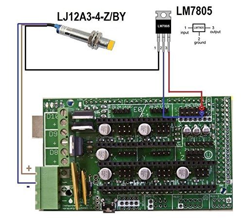

Hello,
I want to add limit detection to a CNC and for this, I got proximity sensors. Here are the specs:
LJ12A3-4-Z/BY
Inductive type proximity switch with PNP Normally Open transistor switch. Output upon detection.
P/N: LJ12A3-4-Z/BY
Power: 6-36VDC
Output Current: 300mA
Detection Range: 4mm
Detected material: Iron/Steel alloys
Note: I already have the sensors and would like to use them and not have to buy something else if at all possible.
A way I saw to connect this was to apply a 12v source to the sensor and then have the sensor output signal go through a 7805 to the input pin of CNC board. But, this is good for 1 sensor.
How would I go about if I want to connect 2 sensors to the same input pin on my CNC board?
Thanks !

You can OR open collector outputs, What do you mean go through a 7805 (regulator)?
Your CNC BOB will need to be sinking input due to the sensors being source (PNP) devices.

I think he means to use a 7805 to drop 12v to 5v after the sensor.
I don't know how close to 5v it needs to be, but I was thinking of just using a 6v ps and use diode or two to drop the voltage a bit.

Yes, BOB means "Break-Out-Box". The pins in a BOB are essentially the pins of the parrallel port on a computer and requires 5v for an "On" state and 0v for an "Off" state. But, by experience, anything between 3.5v and 5v will be good to trigger an "On" state.
Note: The CNC software allow for programming the input to be "active-high" or "active-low" according to what I need.
I decided to use a 12v source to power the sensors because the specs shows they require at least 6v and I was afraid that it would be unreliable if I used 5v.
At first, I was going to use a relay or an opto-isolator to drive the input of the BOB but when I saw someone using a 7805 to drop the voltage to 5v, I thought it may be the cheaper and less complicated way to do this.
So, no matter if I use a 7805, a relay or other means, I still need to figure out how to hook up 2 sensors before that part of the circuit so a sensor's output voltage will not climb up to the other sensor.
I understant the "OR"ing concept would do what I need but my knowledge in electronics is somewhat limited an I wouldn't know how to do this in practice. Is the diodes suggestion essentially doing that?

Yes, I use Mach software on one CNC machine with a Gecko G540. This type of sensor arrangement will also be used on another CNC machine that uses a Linux software with a board named HY-TB3DV-T.
This is where I got the idea for the sensor hook-up using a 7805 (Note: this is not the board I have):
My concern is not the voltage sent to the BOB or parallel port (or whatever is on the right side [pin 3] of the 7805), it is the voltage that one sensor will output to the other sensor if both sensors are connected in parallel (the black wire from both sensors connected together).

Try this.
The 1N4007 diodes will pass the 12v output from either, or both, sensors to the LM7805.
The output from one sensor can't feed back into the other sensor.
Think of them as one way valves for electricity. Current will only pass in the direction of the arrow.

This is what I was looking for. I will try that.
Many thanks!
