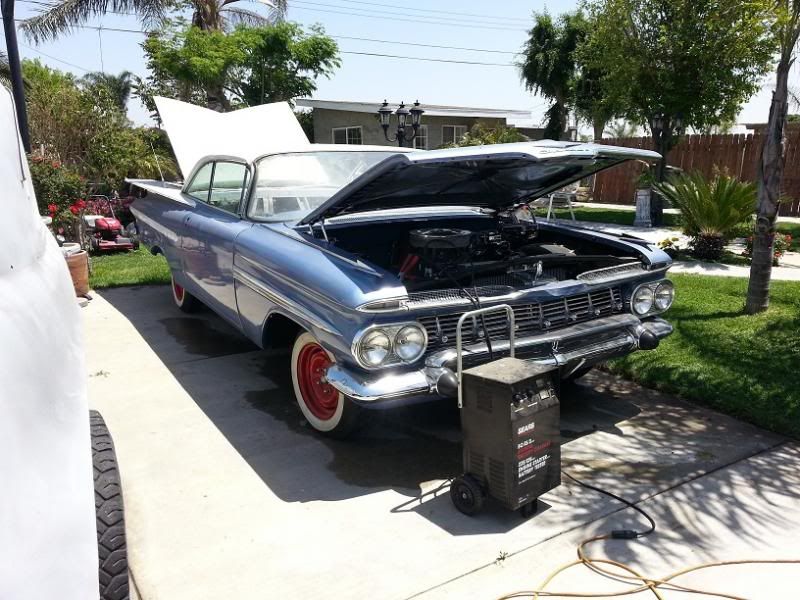

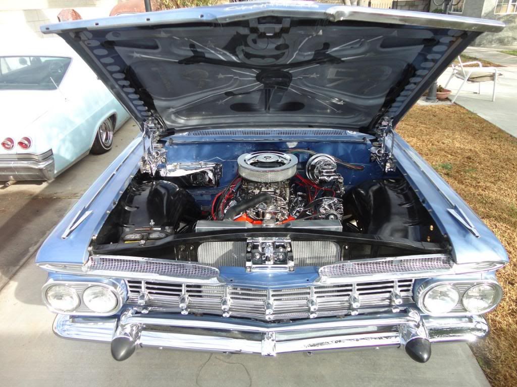

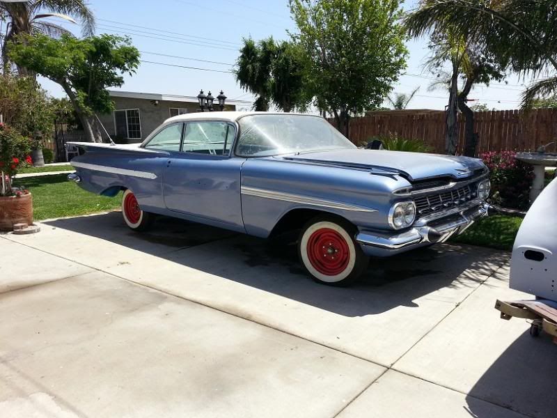

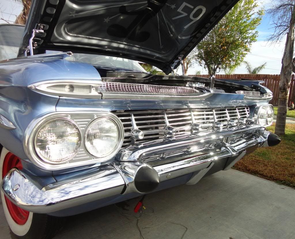

I have a 1959 chevy impala I am currently restoring. I have installed a lot of cool gadgets ive built in the car and made a lot of mechanical accessories to dress up the trunk and dash to display using 12volt actuators, motors and lights. but one project im trying to accomplish im just stuck and cant figure out how to go about accomplishing
