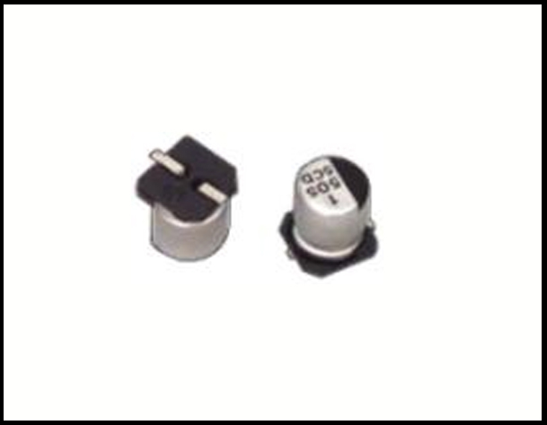

I had never even heard of your brand of amplifier, looks like it might be of 1990 vintage, also there is a possibility that these 22ufd electrolytics mentioned might be surface mounted mini cans and of the type which I am showing just below.
If your units capacitors are of being of this type, there was a total rash of failures of this type back in that time frame.
A good amount were "counterfeit" units that had utilized an improper formulation of their internal electrolyte.
WHILE one popular manufacturer just happened to have erred in his amount of electrolyte put in them, and doing an OVER fill. Those units later seeped out CORROSIVE !, pcb blackening electrolyte, or if used in a fast switching power supply application that caused them to overheat, their bottom seals ruptured.
On this power supply of yours, the principal supplies are its plus and minus 26VDC supplies, with your smaller plus and minus 15VDC supplies branching off of those main plus and minus 26VDC supplies. .

It's good to know that your unit is using standard leaded capacitors instead of that surface mount type, which I showed you .( Those were hard to replace / work with. )
