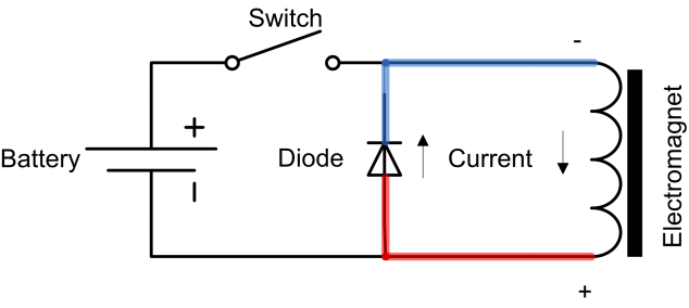

I've been doing some reading- would a diode between (+) and (-) after the timer/relay achieve this? See attached image. If so, how do i select the proper diode?
In the Diagram below the Switch is my relay/timer and the electromagnet is the bell if i'm interpreting properly.

The diode install polarity is being correct and an industry " common as dirt " cheeeeeeeeep priced diode that exceeds the needs by 900% is being a 1N4007.
Not . . . . . INITIALLY . . . . . even knowing your power supply spec, that sounds adequate.
I was wondering if voltage reading was at 12 untill the bell rang and then it decreased to 9V or so with the olde tyme heeeeeeveeee-dooodi i i e bell being activated by the circuit.
On your shown bell circuit, that would only make a single ding upon power application and a fierce continual electromagnet hummmmm until power is removed.
Assuredley, if yours is making a continual ring, the extra shown portions are being on your unit. The diode would still go directly ACROSS the two coil ends of the electromagnet winding with the diodes bar / cathode being connected to the + battery polarity of the interconnecting wiring.

@73's de Edd : Nice drawing. You sure seem to have a lot of free time, don't you? ;)
But I dare say you connected the diode backwards: The anode should go to battery - and vice versa:(. The way it is the diode will short circuit the coil.

Most Honorable and Esteemed Sir Harald . . . . .Le . . MODERATOR . . .EXTRAORDINAIRE
but . . .BUT . . .BUT . . . . .BUT . . . . .?
Nice drawing. (
Gimme a like )
Not being all mine . . . just a stock illustration from MIT's Instructors Learning Centers Resources and my adding additional cells to get up to 12VDC and labeling in the damping diode connections as close to the electromagnets coil windings ends, as could be fitted in the drawings vacant areas.
Really, I also should have moved the "non technical" draftsmans switch placement up to being within the + supply loop at the top.
Sure do, 50 yrs in Mil-Aerospace-Industry then quasi retirement into being a self employed Ind Contractor for lucrative specialized tasks, ( aka . . . .upon payment of my 1K-5K-10K billings, I will then mark my X's on your schematics, after my repairs ) for specialized old military equip or industry. . . . . . .all being jobs opted at my disgression, for the last 20 yrs.
Interpreted as . . .diodes negative /anode/triangle as going to circuit negative line.
" Vice versa " . . . .
Interpreted as being the diodes positive /cathode/ bar should go to circuit + line.
With those info bits being relevant and compared to the drawing.
Strange . . . . . thats exactly the way that I am seeing them on the drawing ?
Now checking verbiage on the textual content . . . strange . . . .it's also coming out the same?
The only situation I am seeing is that damper diode is shorting out the high back EMF voltage developed from across the bells electromagnetic coil upon each contact cycles disruption.
The way we usually use the symbol is: The cathode is the bar, the anode is the triangle. :rolleyes:
The schematic in post #7 explicitly says 'diode +' and 'diode -' without reference to the diode symbol (or would I need new glasses?). Which is definitely wrong. 'Diode +' needs to be connected to battery - and vice versa.
