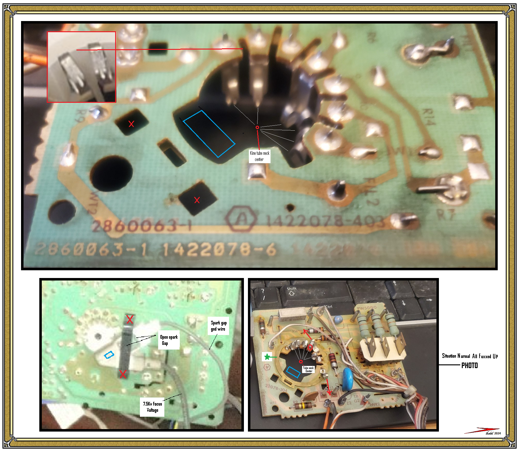

Hello,I need the RCA CRT Circuit board on the right! The model number is 1422078-6. RCA console TV!

I did swap out the tube socket. Show screen grab of the snafu.

Sir DR1 . . . . .
Firstly . . .
Plus with the connector being,Looks like it burned off,especially with the burnt mark on the plastic shield that goes behind this board,
Did not make any sense and register with me at all .
I don't have the benefit of viewing . . .the burnt mark on the plastic shield that goes behind this board, . . .to be able to a specific component against or near to that burnt mark.
Herewith . . . . . . .illustrations, marked up of "Show screen grab of the snafu."
PICKT - CHOOR CITY . . . . .
Top pic is of your largest but it is out of focus and has poor depth of field. The top left inset clarifies a socket pins profile . . .with the two shown . . . a slot in a pin rides across a CRT pin as the socket is slipped onto the CRT neck and its surrounding pins ..
The silver lines radial orientations towards the RED center of the kine neck, depict each slotted connector pins alignment.
Examining the first two pins on the left, they seem in order, then the next one .?. . . . .where is it ? OR am I seeing it being GROSSLY misaligned, and turned 90 degrees off to the right !
The remaining pins are not usable in making a DEFINITIVE evaluation, so lets move on to your other smaller photo. But lets also catch the
BLUE rectangle which is referencing to a connection that has to protrude down into a plastic channel in the picture tube neck connections where there are two redundant pins for receiving ~7.5 Kv focus voltage. That connector is affixed to the two RED X markers.
Now you can look down to the lower left photo, which was snipped from the more technically sophisticated chassis of the earlier original poster. BUT, you both use the same picture tube.
That white connector plugs down into that mentioned CRT cavity and is mechanically clipped down at the RED X points.
There is an open air spark gap with its two rounded electrodes. The flagged 7.5K v focus wire goes down into the kine cavity and connects.
The open air spark gap has a ground wire going to it.
New CRT's have HIGH tendencies of snap-crackle-pop and BANGS ! for the first weeks of use, until its eventual "burn in".
That spark gap spacing and its flash over threshold protects any kine big bang, from feeding over to the focus circuitry and crunching the
" inaccessible, potted" rectifier diodes in the Integrated High Voltage Transformer.
A CONTINUANCE . . .
Now lets start pin connections on the second smaller picture.
GREEN star reference is to the stamped brass ring that encircles the outer periphery of the 7 pins on that socket. Kine flash overs can also relate to all of these pin connections, so the defined and established spacing of them to that brass ring also makes spark gaps for each of those pins.
Starting to the right from the GREEN star the closest pin, and the next two seem to orient their groove properly towards the RED circle center tube neck locus. The same seems true for the 4th one (RED circle) . . .BUT . . .is it pushed back ?
Now the fifth one ? . .? . . ? WOW ! is its slot aligned up on that cermet resistor (RED arrow path) ? . . . its off ~90 degrees to the right.
Next is the 6th pin which also s e e e e e ms to be correct.
Then there is the last and 7th pin . . .WHOOPS ! . . .look at its RED arrow path, off 90+ degrees.
AND it just seems that both pins 5 and 7 are now resting atop the BRASS grounding ring and shorting themselves out to ground ? right ?
OK now, . . . . . is I right . . . . . or is I wrong ? or am, I just . . . . . . . working from squirrelly reference photos ?
Thaaaaassssit . . . . .

Here is what I am talking about,burnt mark. The shield that goes behind CRT board. Thank You for your response!

Sir DR1 . . . . .
Initially, swing that plastic shield rotary positioning back around to where it was, and it will then align up with the kine's socket end.
My HIGHLY educated estimation . . . . . is that is merely being the result of heating of that area, over potential decades of run time.
With that SPECIFIC family of plastic sheet being used, just responding in that way, when exposed to that level of heat and cumulative time of use..
Prior years had the use of a like, thin fiberboard cover that had bends / folds on ends fashioned into tabs to slip into slots on the pcb.
HEAT exposure to that cover type had it bone dry, so that the tabs would break off if even touched.
An intermediate fix was the use of this clip ***** to affix the fiberboard, but the fiberboard still would tear off
1713807167008.pngcanoe clip
Thus the final resorting to of ties to re affix the detached sheet to the pcb, such as yours is now . . . . . and is using bead ties.
ASIDE . . . .
Using your last forthcoming fotie-graff . . . concentrate on the first bend of your index finger and the pcb area near and around and you see darker contaminants deposited or electrostatically precipitated there.
Move up to the RED high voltage wire going to the ultor cap at center point of the picture tube. Stop just short of that cap and get some white toilet paper squares to further down fold into a smaller pad and also get some rubbing alcohol to dampen the pad. Grip the wire inside that wetted tab and move to cleanse about 3 inches of that red wire exterior.
That . . .my friend . . . . is the degree of environmental air contamination that unit has been subjected to in its running lifetime . . . .being electrostatically precipitated on that wire.
Thaaaasssssit . . .
73's de Edd . . . . . .

Initially, swing that plastic shield rotary positioning back around to where it was, and it will align up with the kine's socket end.
That SPECIFIC family of plastic sheet used, just responds that way to exposed level of heat and cumulative time of use..
HEAT exposure to that cover type had it bone dry, so that the tabs would break off if touched.
Thus the resorting to of ties to re affix the detached sheet to the pcb, such as yours now . . . . .is using bead ties.
I just fastened the shield back on with the cable ties,this morning. I bought those solderless connectors to wire that board back into the TV. https://www.amazon.com/dp/B0CD4CRHD8?psc=1&ref=ppx_yo2ov_dt_b_product_details 1713806866400.png
73's de Edd
