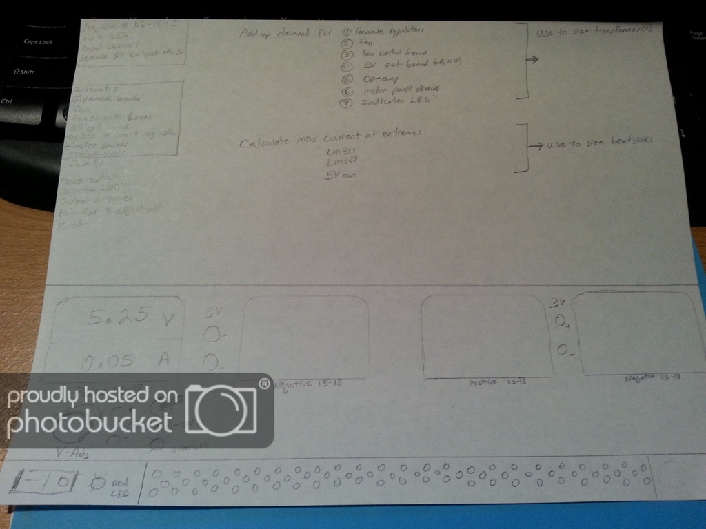

Hello all, I am looking for some assistance in choosing an op-amp to invert an incoming signal. Specifically, I am trying to use a panel meter to read negative voltage.
I hooked up the panel meter to a supply and then tried to use the meter to read the value of a battery in reverse and it was not able to do so. Apparently this type of panel meter can only read positive voltage.
I came across an old thread where someone was trying to use an op-amp to invert the voltage from negative to positive to feed to his meter, but there was much discussion about his op-amp being the wrong choice for use. I am open to suggestion!
After some reading, I learned that the important characteristics would be Avol, Voh and Vol - essentially determining how much overhead the op-amp requires to make its comparision and Vol being how noisy the circuit is? Lower values of Voh,ol are better, as this would mean that as it inverts my incoming negative voltage, it would only lose the difference between the signal and the overhead at the peaks of the rail to rail comparison. (If I have that correct)
I looked at TI's OPA2197 (two opamps since I have two meters that I want to be able to use as negative channels). I am not sure if this is available yet, as it claims new, but a 25μV offset seems to be a very reasonable amount of loss.
Have I made a decent selection? If I have not understood the mechanic behind choosing an op amp, can you please explain?
Thanks in advance!
Edit - I will add OPA2170 to my list as well.

I found a meter - please have a look at the schematic (third photo) - they break the positive connection between the battery and the load to splice the meter inline. Being a current meter, wouldn't this work just as well on the negative side?
The reason I ask this is because with a negative voltage supply, Common is more positive than the negative rail, so the meter would be spliced into the common? Do you think that would work?
Thanks again.

This is a very old problem, "easily" solved by using an isolated power supply to power the meter, as in the Nuts And Volts article... which is quite good BTW.
I haven't used panel meters that also have a current function "built in" to the meter, but it would not be a big deal to add an internal shunt to the same basic LED (or LCD) meter and power both meters from the same low-voltage DC supply. The important thing to note is all of these inexpensive digital panel meters measure a DC voltage that is positive with respect to their power supply negative rail. That means the external voltage which you are trying to measure must be positive with respect to the meter power supply negative rail.
For the dual volt/current meter, the current shunt produces a positive voltage with respect to the meter power supply negative when it is inserted in the low side of a load that is powered from a supply that is positive with respect to the low side of the load. That conveniently means the power supply voltage for the load can also be measured by connecting the other meter input directly to the high side of the load. This arrangement corresponds to the circuit diagram on the left in your link to the current meter.
If you power this current meter (or a dual volt/amp panel meter) with an isolated power supply, you can use the circuit on the right, which (in this example) places the current-measuring shunt in the positive lead of the supply voltage to the load. Notice there is no "common" in the illustrated example. Internally, one terminal of the internal shunt is still connected to POWER-BLACK as well as to IN-BLACK and the other terminal is connected to IN-WHITE. The only difference is the shunt terminals are not referenced to an external ground or other common.
For this meter, with an isolated power supply, you just need to make sure that IN-WHITE is positive with respect to IN-BLACK. So, yeah, place it anywhere you want... high side (-Vreg) or low side (COM)... in your power supply. Just make sure you have the polarity correct. I would try this with a 9 V battery first, just to make sure you have the polarity correct. Then add the isolated power supply to replace the battery. Placing the meter in series with the -Vreg output is better than trying to interrupt the -Vreg common to place the meter there, IMO.
I highly recommend the isolated power supply approach. Using an op-amp requires precision matched resistors to get an inverting gain of -1 and much more complexity than needed.
