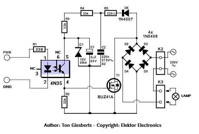

all i need to know is the appropriate value for the resistor labeled unknown value and the right pins for the moc3021

what are you trying to do ??
the circuit isnt wired correctly as laid out so far
one side of the LED in the opto coupler should go to 0V rail
the other side should go to the signal via an appropriate resistor.
at the moment you have 2 resistored leads going to the opto-coupler
that isnt correct

i think the leds not going to be a problem its hooked up to my arduino wich is hooked to my computer i have gotten it to work before with this schematic i will upload it soon
but i want to isolate the circuit so i dont blow up my expensive laptop and/or arduino mega
the reson i posted it here is becouse i need help with the wireing on the other side pins 4 and 6 the arduino hook up is fine

the point is for christmas light controll through vixen (vixenlights.com) my arduino is programmed perfectly
and works i just need something like an ssr but with a mosfet irf640 or another cheap one with at least 8A and 120v and works with pwm i already have an irf 640 so i hope to stay with that one

it is controlling christmas lights on the out put the ac is converted to dc at the begining the irf640 is the switch obviasely and it is controlled by an arduino and opto isolator

oh and the 470 ohm is a pull down resistor so the irf 640 doest get damage when off learned the hard way with ten test circuits

Your circuit is extremely dangerous, the Arduino is going to be at mains potential.
Stick to SSRs, It will be harder to electrocute yourself.

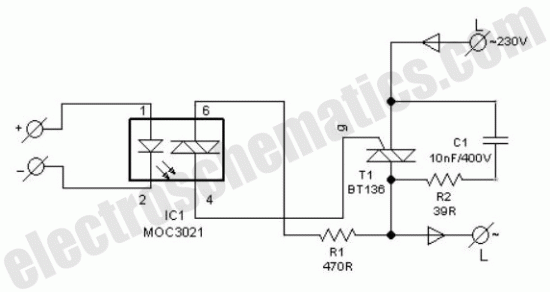

i want to do somthing like this exept with a mosfet instead of a triac and with dc instead of ac

technecally i want the circuit in post 10 except with an opto isolator in it between the arduio and te rest of the cuircuit arduino used as output not input

And that's what you've shown in post #13.
You need a resistor in series with the LED in the optocoupler and the MOC3021 will provide example circuits for controlling the triac.

need help finding right resistor
all i need to know is the proper value for R1 the gate voltage on the irf640 is 5 - 20 volts 20 volts MAX input voltage is 110 vdc not ac

See here. They give resistor values for 110V and 220V
Why do you want t use a mosfet? Do you want to be able to turn the load off mid way through a half-cycle?

thank you, for your reply so i just need to use a 2.7 k ohm resistor for the gate on my irf640 for a 5 volt trigger and yes i am using this as a dimmer via pwm for a christmas light show that is why the circuit is dc instead of ac being converted to dc via
http://www.radioshack.com/product/index.jsp?productId=2062583
yes i am aware that it will turn on when the opto isolator is off and off when the opto isolator is on in my schematic
