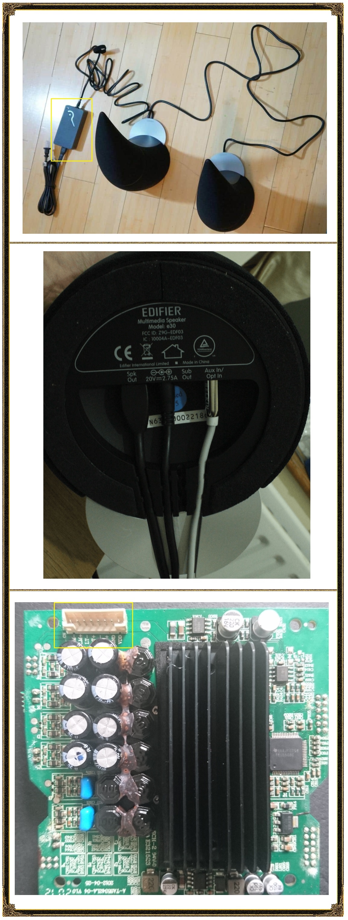

Hi there, so I have had my trusty edifier spinnaker speakers which stopped working a few days ago, it powers up however there is no volume and I assume the issue is connected to the fact there is a strange substance covering a number of components. I assume this is a cap blowing but im no expert can anybody help me identify the issue. Pic's are below

Looking at everything but the third image, I would have said that the capacitors have had their electrolyte leak out and need replacement.
However the third image shows similar goop, but in an arrangement which looks more like the placement of glue than the flow of leakage.
Is the substance in the third image different? Is it rubbery rather than crunchy,
yeah, definitely glue to hold them in place

Sir chidinma onyejuruwa . . . . . . .
(Whew . . . .try as I can . . . . .I just can't say your name . . . . three times VERY-VERY fast !)
Hoping that this is being your units model family.
" I ain't done never heards of enny of these 'a here Edifier Spinnaker . . .Horny type . . .speakers."
No electrolytic failures suspicions at all . . .you are just seeing some of the families of adhesive "goop" that manufacturers use in holding more massive components in place for assembly line operations and shipping..
They are even using a different family on the Class D power amp board around the 10 uh inductors and 4 of the electrolytic. capacitors.
In consulting top photo below, first consideration would be the operationality of the "brick" power supply which powers this unit.
Do you get any LED type of indications of power presence on the main speaker "horn" with its skinny LED indicator ?
The power needs are shown to be a 20VDC supply at up to a drain of 2.75A.
The third photo is showing this unit using a "build" from a Tejas Instrumentations digital processing chip interfacing with some hefty semiconductors on the large finned heat sink for 3 drive channels . . Bass---Mid---Treble..
Start off with checking the power brick for power output.
In advancing degrees of testing involvement, the third picture will need a full top shot of the YELLOW rectangles
markings of the different pins assignments + voltage and polarity info.

Thank's I have just checked and found it gives me 18.26 v. Is this too low as you said it requires 20v?

I would think that you are OK on that 18.26 VDC.
Can we see a photo of the side of the heat sink showing the semiconductors mounted to it . . . and their numbers

Hi there the heatsink practically covers the whole thing i can vaguely make out two chips of some sort. I have also take more pictures. there is a second piece which sits on top of the circuit board

Hi there. Just been looking at your thread and seeing your pictures.
the first lot are just glue that has been used to hold the capacitors so they don't move from vibration.
But the second lot to me it looks like water damage as I can see lots of white deposits on and around the components and connectors.
It could also be some deposits left over from poor cleaning of the circuit board. But to me it's water damage.
I have seem many like it.
If it is then you will have to clean it very well with alcohol based cleaner then dry it out very well.. But normally when I have had these I had to replace the module or devices.

yellow contact cement turns brown and goes hard over time, in hot climates. Also, IT CAN BECOME CONDUCTIVE, which can cause problems, especially if it is on the copper tracks. The black deposits on the other side can also be conductive, and the white deposits happened to me once when making my own PC boards, and wasn't cleaning well enough after etching, IT WAS ALSO CONDUCTIVE ! There could be a film all over the board. Could be worth a clean.with a toothbrush dipped in alcohol or even washing up detergent. Since there are chips involved, even high resistance deposits will matter. You can run over the deposits with an ohmmeter switched to the high range, and the prods almost touching, to verify or disprove the theory.
