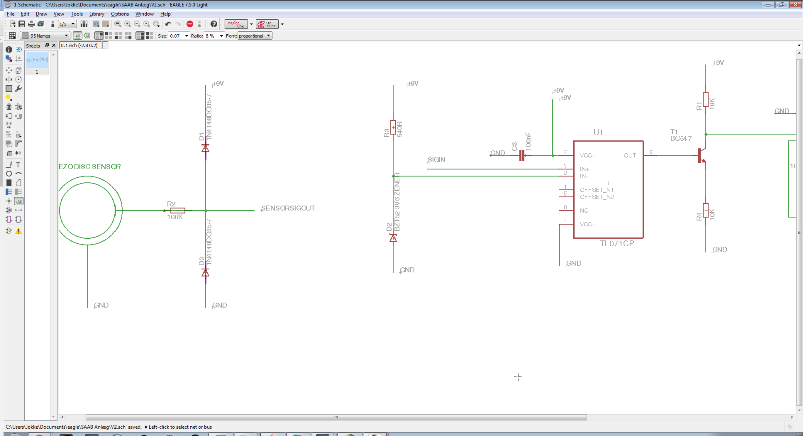

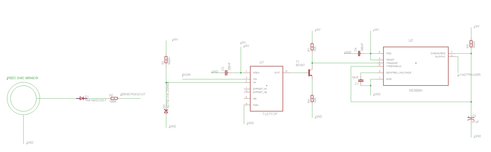

Hi all
My brother, who is a long distance competition shooter, asked me to help him with a small circuit that, when he hits the target plate would turn on a lamp for a few seconds, he showed me a forum where a guy had made just this, using an arduino, but this seems like a much more expensive solution for something that im thinking, is quite simple, so I came up with this, the idea is to simply attach the sensor and/or the whole circuit, to the back of the target plate, im intending it to run off a 9v battery.
The sensor sends out a given voltage depending on how high the pressure is, the op-amp compares it's non-inverting input with the inverting and turns the output high when it exceeds, which triggers the 555 timer in a monostable configuration, which triggers the load.

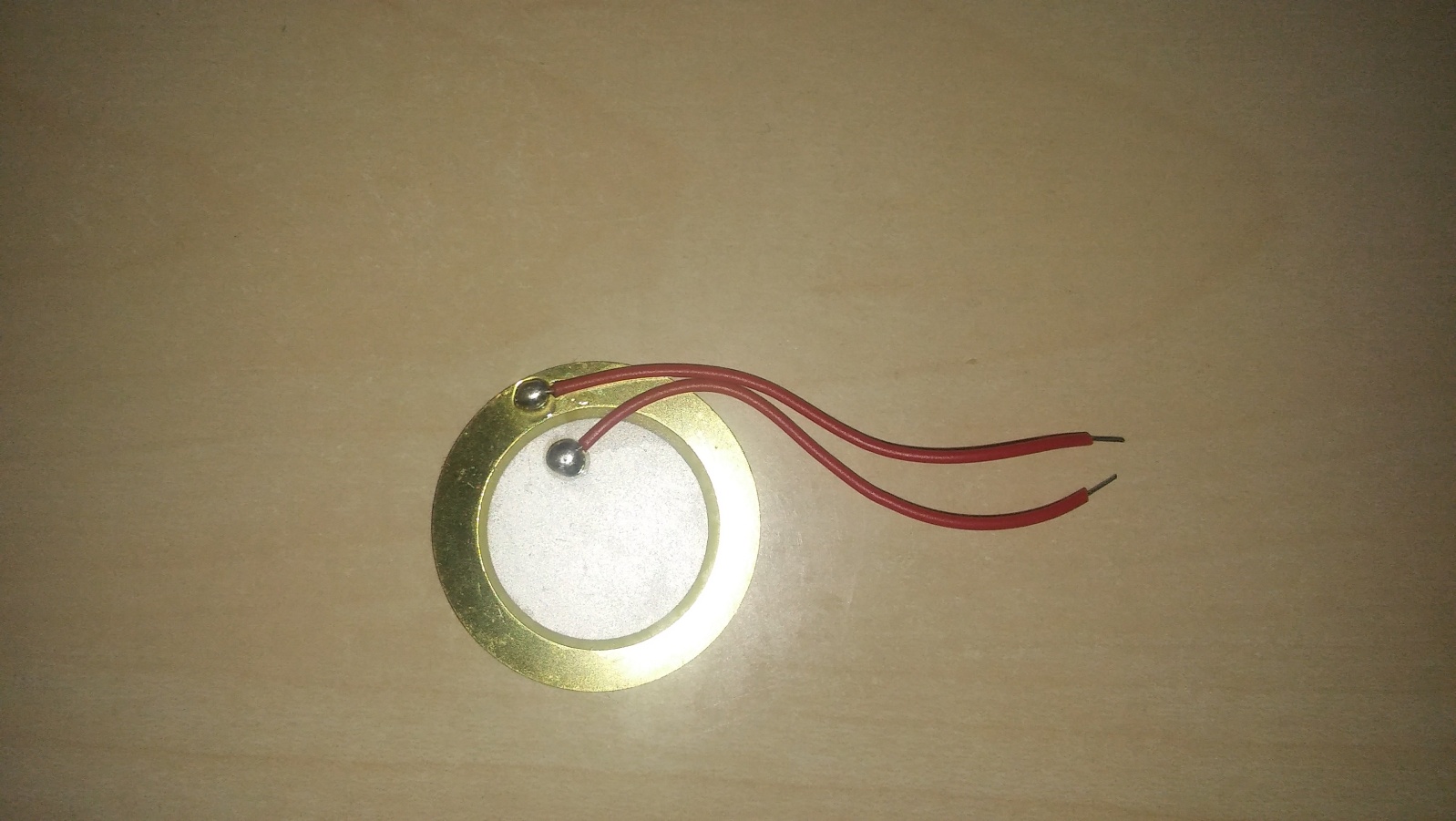

This is the type of sensor im using, I dont have any datasheet for it, not even a name, I bought them on eBay.
If you really put the hammer to it, it almost outputs 100VAC.
I've breadboarded this and experimented with some of the values, and it works exactly the way I want it to work, which I suppose isn't an actual problem, but I've never used these kind of sensors before.
Im looking for some input on the circuit, especially the sensor output and op-amp input, am I doing this right? or will my op-amp have a short life.. Im also thinking of changing D2 with a potmeter so the sensitivity can be adjusted.

You will need to protect the opamp inputs from high voltage spikes. Diodes from R2 to both supply rails will help.
D1 is unnecessary as the piezo generates a bipolar pulse.
The non-inverting input of the opamp may need to be biased to a level close to that of the inverting input.
Personally I'd replace the zener with a resistor.
Both opamp inputs need a path to ground for their bias currents.

Thanks for the input Alec!
Ah ofcourse.. like so?
The non-inverting input of the opamp may need to be biased to a level close to that of the inverting input. Both opamp inputs need a path to ground for their bias currents.
I understand what you mean, but im not sure how to go about doing this without "messing up".. can you elaborate?
Ditch the zener diode for a potmeter, bias the inputs with very large resistors and equally large resistors to ground?
Yep, im planning on doing just this :)
Once again thanks :)

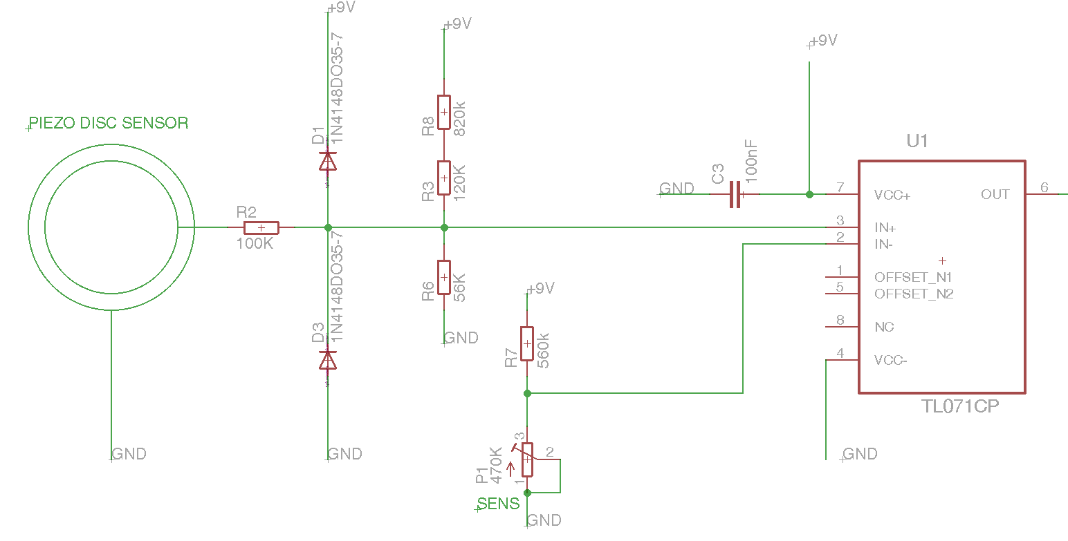

Hehe, it requires 7nA input bias current, well. It's certainly getting that now :)
Hows that looking? is R6 messing with me? will I need a capacitor in series with the sensor now?

The piezo effectively is a capacitor.
Might be an idea to mount the piezo via a slightly resilient layer, not directly on the target plate. The piezo material is brittle.
Yeah, I just thought the current comming from R8+R3 would somehow disturb it or otherwise make it behave "funny" :confused:
Good point, im thinking of just putting the sensor inside the box with the rest of the electronics, unless it becomes too insensitive then..

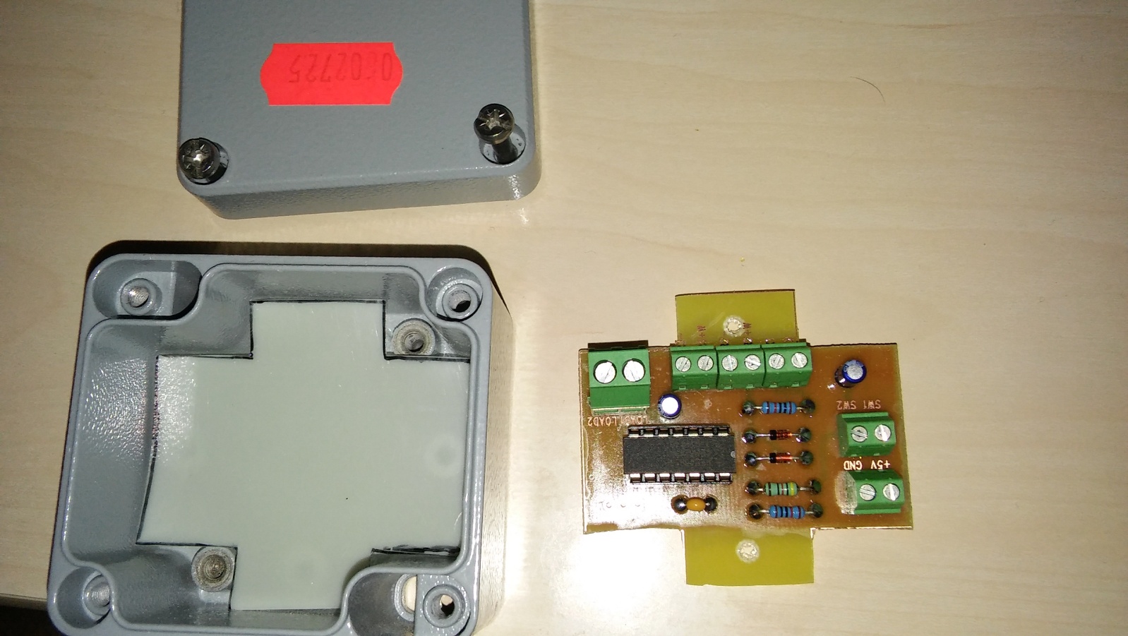

Just thought i'd give an update on this one.
It all worked as it should on the breadboard, so I went ahead and made a PCB for it, it's going to be mounted in the box, after i've drilled the various holes for the pot meters and on/off switch, MOSFET has yet to be soldered, but I think i'll use one of those IRL3034's from a previous project, since I have like 30+ of those lying around.
Here's a picture of the work so far:
Never mind the mounting holes there, there's a different set of holes in the box that I will be using :)
