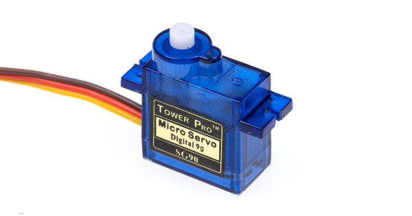

can someone please help?
i need to build a circuit that has combinational logic, flip flop and servo in one circuit.
i keep trying to search it but all ive search was either too hard or i simplt cant understand it

this is the servo we need to use

You need to refine the very, very, very general "requirements" into a detailed task description. Then you can design a circuit from that. For example:
  • Design a circuit that has 2 buttons.
  • Pressing button 1 shall move the servo in the leftmost position (e.g. unlock door).
  • Pressing button 2 shall move the servo in the rightmost position (e.g. lock door).
  • When no button is pressed, the servo shall stay in its current position (or define otherwise, e.g. lock the door in this case, as you deem fit.).
  • When both buttons are pressed, the servo shall stay in its current position (or define otherwise, e.g. lock the door in this case, as you deem fit).
Or define any other list of requirements that you think you can solve. You may have to look up on the internet more details, e.g. what supply voltage to use, how to control the servo position etc.
Hint: you will need a clock source.
If you can't, you're probably not yet fit for your final exam, sorry :(

i am very sorry i cant put it in words, sorry for my poor english but ill try to.
So our project needs to have combinational logic, flipflop and servo in one circuit and all of that needs to be all connected with each other.
I am thinking of building a door lock with one button that locks and unlocks it
Just a context; our project was to make a combinational logic and need to apply it to real life things (i made a self defense alarm) i alarms and lights up when you click the button.
On midterm we are tasked to make a flip flop, in this case i made a coin tosser using two LED's.
However on pur final we are tasked to combine the combinational logic and flipflops to the servo.
We are only tasked to do this without any guide that is why i am having a hard time explaining it to you guys, i am very sorry and thank you all for understanding.
A servo like the SG90 in your image is not controlled by a simpel on-off signal. Instead it is controlled by a signal with fixed frequency but varying duty cycle (see e.g. this explanation).
You could either create a single clock source with variable ducty cycle, or for a simpel lock/unlock application use two clock sources with different duty cycles and use a multiplexer to select either of the clock sources to turn teh servo in the locked or unlocked position.
That's as fas as I can go in the homework section. You need to do the design for yurself. You're welcome back when you have a specific question, but we can not and will not do the design for you.

There would be several around using a 555 timer.
Operation is not strictly flip flop but it does flip from one setting to another and then another depending on button presses.(or not)

Timothy has responded like an AI to the suggestion by @Harald Kapp to use a two-button set of switches to operate the servo configured to operate as a door lock... or any other sort of lock. This may of course simply be a communication problem as @mothman learns more English. It does seem as if a flip-flop could be folded in here, and I really like Harald's suggestion to use two frequencies to set the servo position. Nevertheless, it does appear that the original poster is not sufficiently prepared. But not to worry too much (unless time is of the esseence) because lessons are repeated until they are learned.

Addendum: If you are going to use just ONE button to change the state of a flip-flop, don't forget to de-bouince the switch before applying the logic state of the switch to the clock input of the flip-flop.
