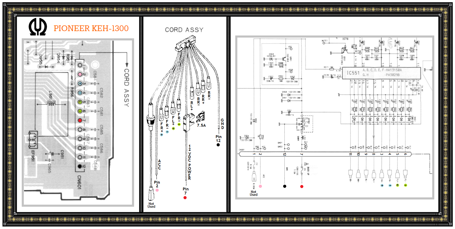

From a newbie: I would like to know the maximum amps that most car radio's use. The radio I'm working with is a Pioneer KEH-1300. Any help would appreciated.

yeah the radio is a Pioneer KEH-1300 I also tried looking for specs, all I know is that, of course, the system runs on 12volts times ??amps = ??watts
so does it have a watts per channel on a label on the unit ?

the radio literally has no specs whatsoever except for the brand name and series
so it doesn't have this label on it like this one I found ?
there's big scratches through the power rating
going by the French version it looks like 20W x 4
so it has 4 channels out they will likely be left and right for front and back speakers

Sires . . . . .
All Maxxxxed out . . .at VOLUMUS MAXXXXXIMUS . . . . it will be pulling 10 AMPS thru the 12VDC power wire coming into the radio.
This, considering that you are additionally stomping the floorboard and keeing time to the music by beating on the dash.

Sir Ben King. . . . . . . .
With what you have shown us, looks like you are in luck, since this unit goes back to the 90’s and you did not show the presence of the deluxe, SEPARATE Power amplifier pack.
Therefore . . . it must not have been pulled from an ‘ole Catarack, Rincon Contirental or Mercy-days.
I have given you snippets of the connections of the foil side of the PCB proper which you were running your fingers over.
The proper plug and wiring harness which would have been used on the unit.
With the third part . . . being the concerned section of the schematic.
So it looks like the use of 7 “wars” connected to the unit, along with an antenna, might have that lil’ puppy yelping again . . .with glee.
RED for power
BLACK for ground
PINK for constant power for electronics u/p memory retention
4 wires being used for the Front Left and Right speakers.
IF this is NOT just someone’s cast away non-working radio.
Query me if there is something not understood and also explain your planned operation . . . to catch you prior to possibly making any boo-boo’s.

which one would the antenna or is there an antana

Sir Ben King . . . . . . . .
Look just across the rear of the radio . . . . from our present area of interest, of the plug for the wiring harness . . . . there you should find a black doggle hanging there . . . . with its internal Motorola receptacle .
Trace down its end connection going inside of the radio and where it solders onto the board circuitry. You should additionally be able to solder tack on about 4 feet of hook up wire and route outside of the radio to fulfill for an ersatz antenna for testing purposes.
Plus . . . . you only have too hook up one speaker to initially see if you have a working radio.
The radio should only be pulling 1/4 of an amp of power at no volume and then increase incrementally as you up the volume level and finally, just lock at the max level possible . . . . . with your last gasp of supply power current availability

I actually have one more question :D :p would 3.25A cut it for "normal listening level"
