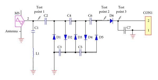

First of all, I follow this schematic diagram from this article - http://www.hindawi.com/journals/apec/2010/591640/

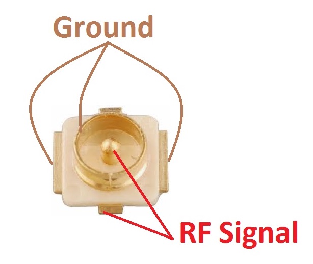

1X 2DBI 2.4-2.5GHz wifi pcb internal ipex antenna , like this:

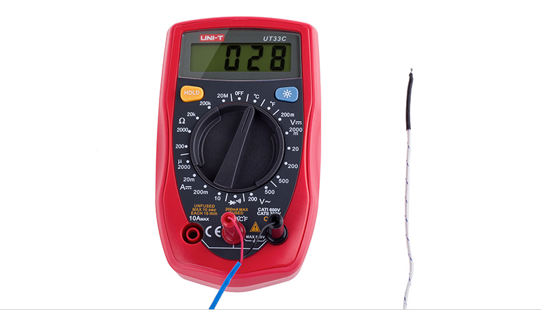

1X UNI-T UT33C DMM
C1 is made up of 11X 1pf capacitor in series.
L1 is made up of 5x 0.1uH inductor in parallel.
C2=C3=C4=C5=C6=C7=1pf capacitor

When I place the antenna vary the distance between 1cm to 3meters in any direction from my home wifi router, zero volt across Test point 3 with ground point , even zero volt test point 1,2 with ground point measured by the DMM.

1. What is MS in the schematic diagram that illustrated in the research ?

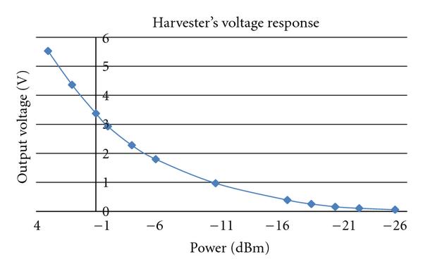

They mention about the power...
They have plotted a graph about received power against output voltage. In my case, I use mobile phone to measure received power about -23dBm, according to this graph, I should get around 0.1-0.2 V, however I get 0V..

I really think you don't understand how tiny a power level this is
... Gryd3 summed it up nicely in his opening comment in his first post
Let's stop you here before you go any further.
What you are doing is not going to give you anything useful. At all, even remotely.
do you really understand how small a power level -23 dBm is ?
that is 0.005 mW

As a comparison. The 0.005 mW Dave posted would mean that you would need to be able to store this energy. The tricky part here is that the 0.005 mW will get smaller as it deals with components in your device 'before' the storage.
To put that scale to something useful... a 3.7V 20mA white LED is going to require 74mW to light.
That will require 14,800 seconds of charging at 100% efficiency to light the LED for 1 second.
The other problem is that the storage device you are using will suffer from something called 'self-discharge', and if you need to pass this energy through a converter or charge controller of any sort, you will loose the energy.
At some point, the energy is just too small to harvest to be able to do any work with.

@allhksar You are correct that the forward voltage drop of a diode is a function of current. If you look at the V-I curve for any diode the forward voltage goes through zero at the same time the current goes through zero. The reverse current is small (but never zero) as the reverse voltage starts at zero and becomes increasingly larger, becoming a constant reverse leakage current until either zener or (more likely) avalanche breakdown occurs. Given these characteristics any diode should certainly act as a rectifier, even for microvolt level signals. If this were not true, it would be impossible to build a crystal-radio receiver, something every budding electronics enthusiast should do at least once in their life!
However, the V-I curves reflect the diode behavior under steady-state DC conditions. Add in a gigahertz or so of AC signal and other considerations enter the picture, the most important being junction capacitance (which acts as a reactance in parallel with the diode) and reverse leakage current (which acts as a constant-current discharge path in parallel with the diode). Together, these two factors limit how much DC "power" you can extract from the diode-rectified AC signal. It just gets worse when you add voltage multiplier stages and you reach a point of diminishing returns after three or four well-designed stages.
Another consideration is your antenna. The authors of the paper you cited constructed a double-sided microstrip dipole antenna for GSM band without giving much detail. Okay, they didn't give ANY detail, but a later image (Figure 14) shows a larger dipole antenna (perhaps for a lower frequency band?) connected to what appears to be a strip transmission line. The authors also mention using series-tuned LC filters, and one such is shown on their schematic in Figure 8, but they were similarly lacking in details, although the left side of Figure 13 appears to be involved with this. Note also that the voltage multiplier appears to be constructed with SMD components, probably to help control parasitic capacitance. When working at gigahertz frequencies, circuit layout and construction are critical to obtaining expected results.
I don't see an antenna in any of the images you have posted so far. Are you using a monopole (rubber ducky) type antenna? Sounds like it, if the "gain" is just 2 dbi. You should try using a dipole antenna cut to resonate with the transmission frequency of your WiFi wireless router.

Edit: BTW, MS on the schematic stands for Micro Strip.
