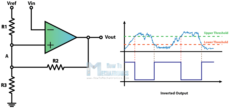

Hi. This should be easy question to answer, but I am a noob so... sorry, but I build a Non-symmetrical Schmitt Trigger using an op-amp UA741CP and 3 10K resistors.
Power supply is 5V. So, as far I found on the internet the output should be 0V when Vin is above the threshold, and the output should be 5V when Vin is below the other threshold.
Source: http://howtomechatronics.com/how-it-works/electrical-engineering/schmitt-trigger/
The threshold for turning ON is 1.6V and the threshold for turning OFF is 3.3V. That part is working fine. But the output is not really 0V for OFF, is actually 1.6V. And the output is not really 5V, is actually 3.3V.
This is what I did:
Why output is not ON/OFF (5V/0V)? I am using the wrong op-amp, or I did something wrong?
I really appreciate some help, because google didn't help me on this question.

You have 2 problems.
The first is that the 741 is not really specced to operate from a power supply as low as you are using.
The second problem is that the 741 can't drive the outputs close to the power supply rails.
What you want to look for is an op-amp which has "rail to rail" outputs, and is specced to operate from a 5V single ended power supply. I'm not in a position to look one up for you right now.

Yeah, you'll find that the 741 has problems pulling the output within about 2 V of the supply rail. If you use a 5V rail, you get about a 1V swing on the output.
This is affected by load, and clearly you're getting a bit more than a 1V swing.
Rather than looking for an op amp with a rail-to-rail output and trying to source it locally, I suggest you determine what is available locally and see if any have the appropriate specs. (This works better when the local choice is limited)

To answer some of your questions...
Post #3, the circuit is architecturally OK, but the 741 will not function as indicated under those circuit conditions The output voltage range is not close to 5 V overall with a single 5 V power supply.
Post #5, yes it says a 741 will operate with Vcc+ = +5 V. But it also says that Vcc- must be -5 V. Note that it doesn't say how well it will operate. That is in another section of the datasheet.

I try with the zener diode to force a 0V LOW, but I found that is too slow. I am using this for high frequency, so the zener diode can't keep up.
Like I say, I am more interested on having a 0V LOW, than a 5V HIGH. Sadly I could not find a rail-to-rail op-amp so I am stuck with the op-amp I got.
So, I need to build something to do the job of a zener diode, but without a zener diode because is too slow. I thought maybe with a transistor, but so far I can't find something that could trigger the transistor at a fix voltage, and turn completely OFF when is lower than that voltage.
Any suggestions?
