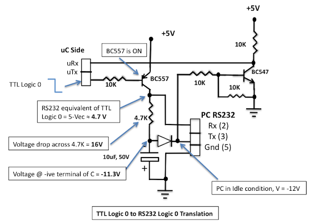

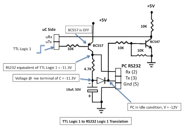

I am seeing few people commenting on the polarity of two capacitors that are used in two of my projects posted here, namely Learning board for PIC12F683 and Single chip temperature logger.  Both are 10uF, 50V capacitors and are used in TTL to RS232 Level shifting sections of my projects. It seems like they are connected upside down, but that's not true.
In order to translate TTL logic '1' (which is 5V) to RS232 logic '1' (which is -3 to -12V), I need negative voltage supply. Since I don't have one on my board, I am stealing it from the TX pin of PC RS232 port. At idle condition (when PC is not transmitting), the TX pin is at logic '1', i.e., at -3 to -12V. I am taking that negative voltage and feeding it back to its RX pin through a 4.7K resistor. So the +ive terminal of the capacitor is grounded, and the -ive terminal is connected to negative voltage supply, which is a proper way to connect a capacitor.
The pictures attached here describe how this works exactly.
And, when the PC is transmitting, the reverse biased diode connected between the TX and -ive terminal of the capacitance protect  it from charging in opposite direction. I didn't mention all these details in the project because I thought it would be too much to put on a hobbyist corner. I hope this answered why the capacitance is connected the way it is.
Thanks.
Raj

You're right, thanks for signing up and offering an explanation.
I didn't understand how it worked but now you've explained it properly I get it.
I'm glad to see that the web master has changed it back.
I'm sorry about making the mistake but it actually further proves my point: if a design is not subject to a proper peer review, then it can easily contain errors. Just having one or two people review the circuit before it gets published is not good enough. We need to discuss new designs first, as we're doing here so we can iron out any errors before they are published.
There were some other changes I made to the schematic which I feel would make it work more reliably which have now been put reverted. I'll repost them and if you agree, I'll ask the web master to change it.
1) There should be no need for a resistor in series with the piezo buzzer, it's a high impedance device so there shouldn't be any need to limit the current. Was it just to loud and you needed to reduce the volume? If so I think you could offer an explanation,
2) Is it a piezo buzzer with a built in oscillator or just a piezo speaker which needs a squarewave to work?
3) It will probably work with 4k7 but the transistor will run cooler with a 470R base resistor because the saturation voltage will be lower.
4) Again, it might work without a 100nF capcitor in parallel with the PIC but it's always good design practise to include one.,
5) The minimum operating voltage for the LM7805 is 7V, below that it will fail to regulate and the output will fall, so that should be 7V to 12V not 6V to 12V. Source: datasheet http://www.fairchildsemi.com/ds/LM/LM7805.pdf
