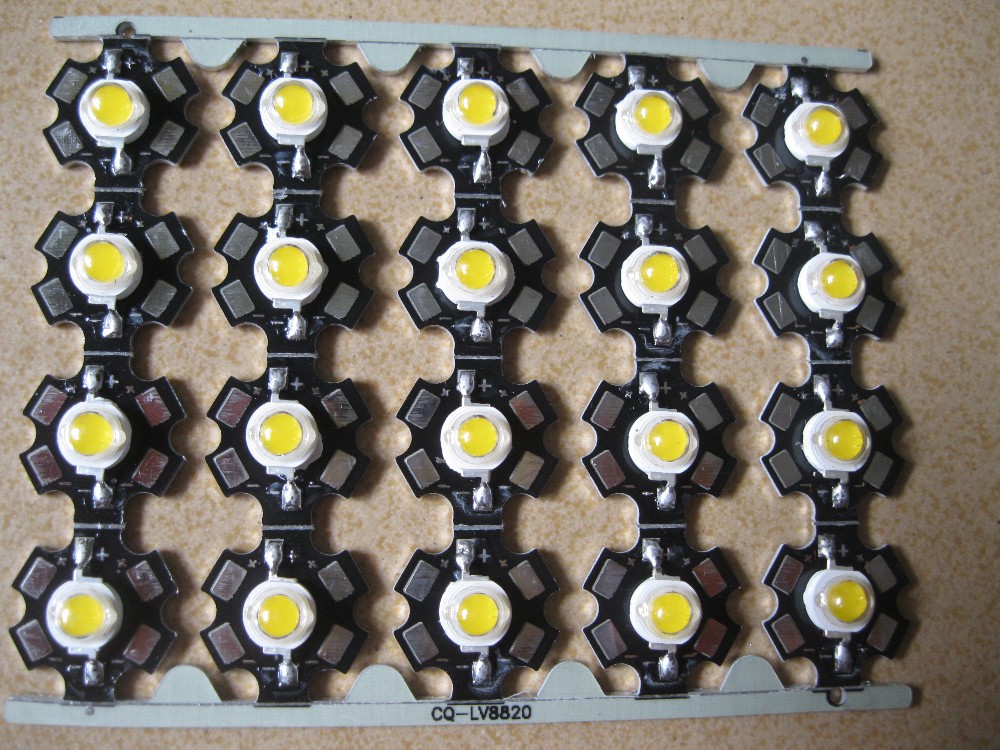

I am about to buy several 3w white LED's that are mounted on heat sinks. Their power requirements are 3.6-3.8vdc forward voltage at up to 700ma. I can drive strings of these with a mosfet using PWM from MCU, but my real goal is to drive them like the WS2812B to allow me to individually address them to control each LED's brightness. Of course, I want to only have one clock and data connection to the array, so the individual control circuitry needs to be able to condition the signals and pass them on, with overflow of the data, just like strings of the WS2812B does. Except I am only concerned about one channel of PWM. 8 bits should suffice.

And is there a mosfet you recommend for this task? The LED's I am getting APPEAR to be the 6500k version,
180-200 LM 3w and look like tiny poached eggs. :)
Specifications:
LED Emitter: 3W
- Output Lumens: 180-210 Lumens
- DC Forward Voltage (VF) : 3.6-3.8Vdc
- DC Forward Currect (IF) : 700mA
- Color Temp: 6000~6500K ( White)
- Beam Angle: 120 degrees
- LifeSpan Time : > 50,000 hours

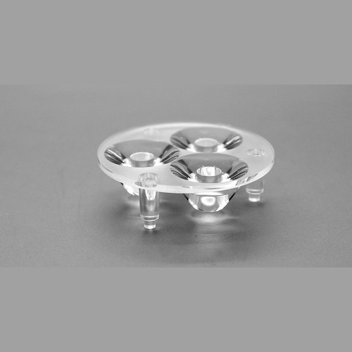

Am I looking for N channel or P channel? I also found a cool diffuser that might serve my lighting pod needs. Daisy chaining these modules with one WS2811, 3 mosfets (not sure which one yet based on my LED specs), a circular board I will design, and connectors. I thought about changing one of the LED's to a 2500k warm white spectrum for my plants. So 2x 6500k and 1x 2500k. Daisy chained as needed and using the WS2811 to control intensity. Maybe with a STM32F1 Arm Cortex MCU. I'm excited!!

By the way, those LEDs you show are not on heatsinks. The little board they're on is what you attach to a heatsink.

Thank you, I did not know that about the heat sinks! I will consider that in my board design that I place 3 of these on. I guess I will need to do some thermal testing. I have just the thing for that though, and be able to chart it over time while testing with PWM.

I heard of the RGB 3w versions. Are they all under one diffuser?
BobK
Jan 5, 2010
7,682
Jan 5, 2010
7,682
The ones I have are all 3 under one lens, but it is clear. They are in an application were there is an outside diffuser.
I always considered the lens as the diffuser clear or otherwise. I guess because even clear lens diffuse to and angle somewhat. Thank you for clarifying.

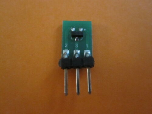

Yes, I appreciate that. And it would have been my end goal device. I also realized that I can solder these to a through hole prototyping board to work with,
or better yet, use a Double-Side SMD SOT23-3 to DIP SIP3 Adapter
http://www.ebay.com/itm/like/262548612714?chn=ps&dispItem=1 for about 15 cents apiece.

Isn't Ebay great, Adapters like that used to cost 10 times as much as the part they were adapting.
