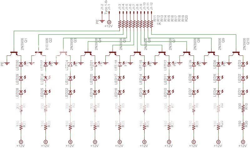

The first schematic shows green LEDs driven from two LM3916 ICs set for an output current of only 8mA. The input of the IC is a half-wave rectifier so the LEDs average only 4mA when the music is blasting.
If the green LEDs are 2.2V and the car battery is 13.8V then each output transistor in the IC dissipates an average of (13.8V - 2.2V) x 4mA= 46.4mW. The IC dissipates a little more than 464mW when all 10 LEDs are lighted and the music is blasting. The max allowed dissipation of the IC is 1365mW.
My Sound Level Indicator uses a peak detector that lights the LEDs continuously instead of half-wave. They are set for 25mA each so the IC gets hot. I added a power resistor in series with its power pin to share the heat.

The first schematic didn't use green LEDs, all I had were yellow and red to test my prototype. The actual output of the LM3916s drives 3906 transistors to run blue and yellow/red LEDs.
All home made.
I've had my photos at photobucket for over two years with no problems and only change because I changed them. I wanted a rapid response so I opted out of a peak detetctor. This actually increases LED efficiency and longevity as well.
The "fuzzy" is from selecting a low resolution when I converted from my CAD program to JPG.

Here is a copy of the fuzzy first JPG schematic you posted on another website. It lights the green LEDs half the time because it is half-wave and does not have a peak detector circuit. The LEDs average only 4mA. The LEDs are a dim blur without the peak detector circuit.

What green LEDs are you talking about? There are no green LEDs in that circuit whatsoever. Never have been. NONE!  AND as I've explained the ouptut drives a transistor not an LED.
I didn't want a peak detector because it's better for the LEDs as it makes them more efficeint and increases their life span. I'm not sure where you are getting they are a dim blur?!?!? They are very bright in fact.
So the schematic is fuzzy, I'm not going to change it. I don't need to. I have the schematic in my CAD program and that's good enough for me.

My last post shows a copy of your schematic that you posted with green LEDs operating at a low current.
Your low level LEDs are bright. But the high level LEDs are dim because they are turned on for such a short amount of time that our vision can barely see them. When the pulse width is less than 20ms then they look dimmed. Many pulses are less and on your simple circuit they cannot be seen.
A peak detector circuit turns on every LED long enough to be seen brightly and clearly.
Your LEDs are lighted for half the time because the input is a rectifier. Then your brightest LEDs are also dimmed.
The datasheet for the LM3915 bar graph driver recommends using a peak detector circuit. Every "VU" meter circuit I have made has it. You should try it.

Try going by what I have connected instead of what I have drawn.
It's apparent you don't understand the advantages of making LEDs efficient. My LEDs are lit for half the time because I wanted the efficiency. My LEDs are just fine, but thanks anyway. The effect is still there.

Leds that are turned on for half the time by rectification are efficient only because they are dimmed by the 50% duty-cycle. Most of my LED circuits use pulse-width-modulation for adjustable dimming. But they can increase the duty-cycle to 100% for full brightness, yours cannot.

I don't need them to, that's the difference.
Why complicate a "SIMPLE CIRCUIT" that works just fine for what I need? If it ain't broke, don't fix it.
I am working on an adjustable PWM for my internal LEDs using an AVR, probably an ATTINY2313.
