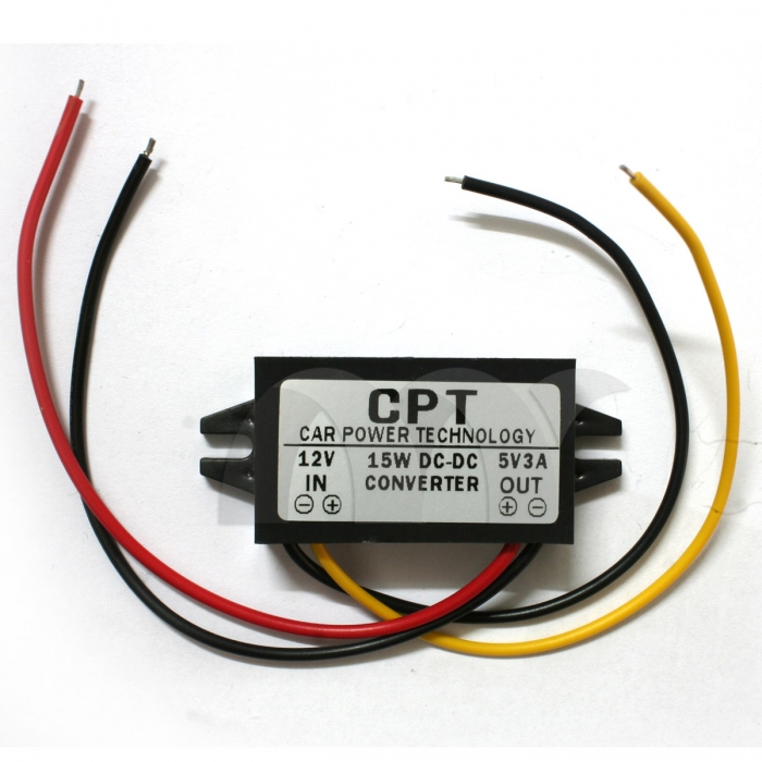

I have a 12v to 5V 3A convertor. What would be the best way to further reduce it by at least 0.75V? I was thinking of a resistor but that will be generating a lot of heat. Is there a better way to reduce the voltage and have it stable? The current draw will vary. In most cases it probably won't draw full 3A but can sometimes peak at that.

Thanks for that very informative post. I'm basically running a Android tablet directly from a car power source and getting rid of the battery of the tablet. Currently it works fine with the 5V but I don't want to risk frying it. Most people have said that the tablet can support upto 5.25V and the range is between 3.85v and 5:25v, but I would rather be somewhere in the safe range around 4:2ish

I don't think it will be possible to set the voltage on the converter I have as it is enclosed. Below is a pic of the converter I have. I think I will wire 2 1N5822 diodes in series and see how that goes. If the max voltage drop for each diode is around 0.525v then 2 in series will have a max drop of just over 1v, which is not bad as it will bring the voltage to the desired 4V. If however, the tablet is drawing less current during less intensive use and the lowest draw is 0.25, then 2 1N5822 diodes will bring that down to 0.5v and hence I should still get 4.5v which is much better than having 5v.
