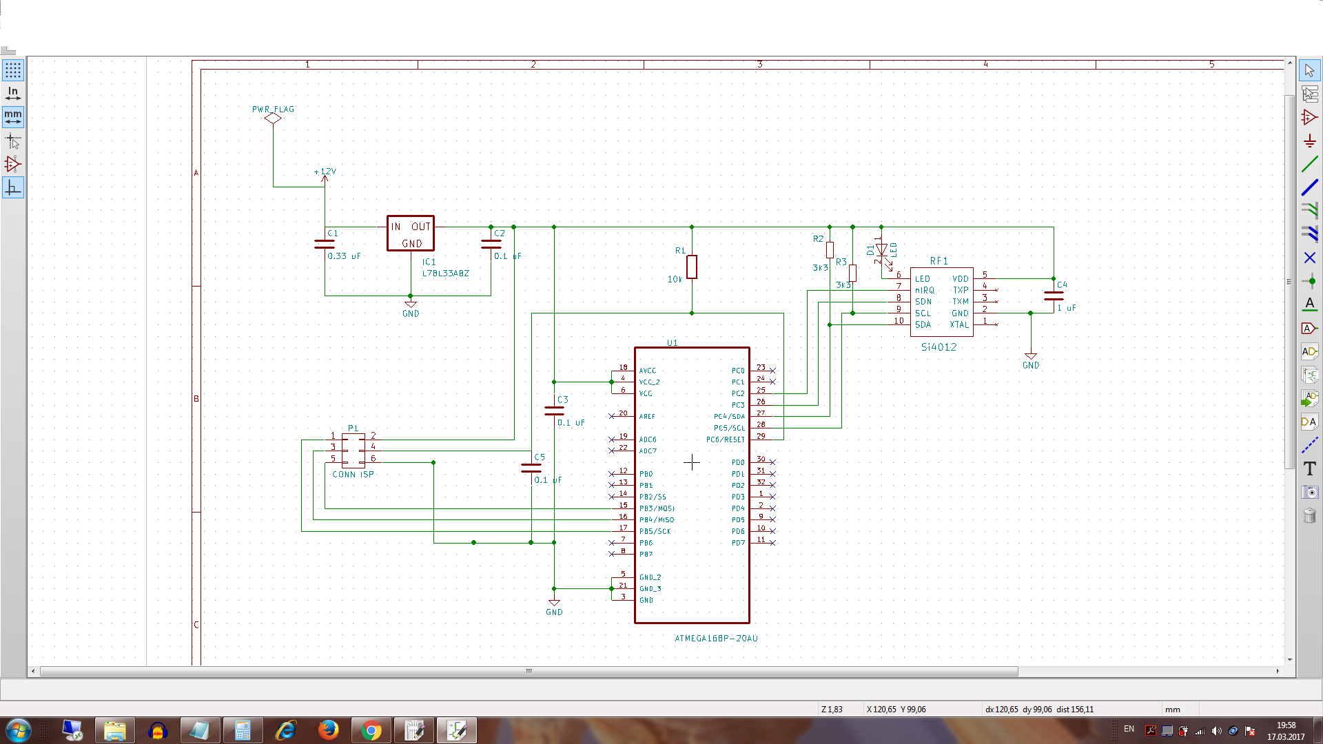

Made my first PCB, yay! a MCU and a RF transmitter mainly. Programmed it OK through the SPI interface (which has a power pin feeding it stable 3.3V). All worked fine.
The circuit is intended to run off its currents at 12V obtained from a car lighter socket. So I have soldered the car plug, plugged it in and within 2-3 seconds there was smoke coming out. Pulled it off and visually inspected. Nothing gave any clues as being fried. Done this a second time with brand new PCB and parts, same deal.
A multimeter verification revealed that Vcc and GND were shorted. Took out everything except the MCU and RF transmitter - the board was still shorted.
My voltage regulator is a good old TO-92 L78L33AB which I have used just like in the datasheet example: one 0.33 uF capacitor on the 12 V rail and another 0.1 uF capactior on the Vout = 3.3V rail,
My first thoughts were heat dissipation problems, but after doing the maths it doesn't seem like this would be the case. Got about 25 mA drawn by the circuit and the car socket reads 12.3 V. Let's round it to 30 mA. With a thermal junction-ambient coefficient of 200 deg_C/W this would give:
(12-3 - 3.3) * 0.03 * 200 = 54 degrees rise.
Not that much to cause the failure I have witnessed twice. And it has worked fine if stable 3.3V was fed to it through the programming interface... Any pointers ?
  • Which component(s) are shorted?
  • Did you try the same circuit operating from a 12 V lab bench supply?
  • Did you ensure that there are no short circuits anywhere from the PCB to the car lighert socket?
  • Is the 0.33µF capacitor on the input rated for >12V supply voltage?
  • Last not least: is the voltage regulator inserted correctly?

Will do! I have taken out the RF chip - this is the one getting shorted. Board now does not short any longer.
Checked the specs again
- RF chip max voltage: 3.6V
- voltage regulator max V_out: 3.465V
*edit*
done the measurement on the PCB that I have taken the RF chip out. I have managed to take a 12.3V reading just before more smoke risen to my scent detector. Pulled it out and felt the parts. It was the voltage regulator the one overheated. The PCB hasn't shorted again this time. So my math above must be wrong...

It can be seen here how the fat reddish cap's left foot goes into the voltage regulator through a wide trace. I am feeding the PCB through that fat cap.
Have I really put the voltage regulator backwards ?
well that cannot be correct as DC doesn't go through caps
can we please get another pic looking down on the board, showing the power connections
where this connected to....
- fed with 5.1V - measured 14 mA max
- fed with 9.7V - measured 0.01 mA
you existing pic just shows a small section and yes according to the silkscreen J1 appears to be connected correctly
do you have schematics or something you followed to build this up ?

plus the layout of at least the voltage regulator section. There may be more errors.

Hope these are fine. The red fat cap is C1 on upper left side.

The layout confirms Vin and Vout of the regulator are swapped.
Apart from that I can see no obvious fault with the layout.
