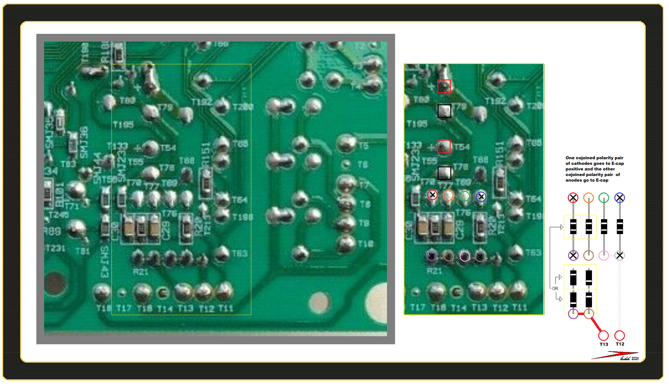

I cleaned the area a bit with acetone. I see there were 2 traces on pcb that seem to connected to the 2 terminals of the burnt out capacitor (please see the picture below).

By the way after cleaning the area I see that the diode on the other side of the pcb has no connection to this capacitor the way I described on the first post of this thread. This capacitor is a separate component on the other side of the pcb.

Sir bijanelectric . . .
If you want to do a more noteworthy, NASA / MIL SPEC / AEROSPACE / PROFESSIONAL type of rebuild . . .instead of currently suggested downgrading to a dismal "shoe patch job " + chewing gum, additionally using, Scotch tape, toothpicks,sooper glues, "DUCk" tape and a well chewed up B flat clarinet reed.
Build up a duplicate set of four diodes on a hand made PCB or foil perf board, so that its 4 corner leads line up withe the original
RED-BLUE-VIOLET-GREY corners . . . . . that I Have BLACK X's within.
They will then electrically connect and physically float the board either above or below the board . . . . if there is being the constraints of a plastic cover around the whole board proper.
You initially have to remove ALL carbonization residue, all the way down to the bare board,
A burr chucked in a Dremel tool does that easily . . .or the use of a #11 blade mounted in an Xacto handle, will let you laboriously scrape all of it away.
Pull off the C29 and 30 monolithic block SM ceramic caps, and replace them with conventional leaded units of 0.01 @ 50V placed on your rebuild board.
If you need any more help from me I would need. . . . .
The voltage ratings and capacitances of the two RED and BLACK squared E-cap you see marked up.
An idea / measurement of the "T" designated power transformer AC voltage outputs . . . . with me already expecting . . ~ 12'ish for the power / mechanical relays onboard . Also an -80-100ish voltage for the units PANAPLEX display.
The polarity of the installed diode bands.
As you can see I CAN confirm transformer RED foil path to term T13 feeding into my two diodes shown options of their bands . . . one anode and one cathode shared.
Confirm if my temporarily ghosted in connection foil path from T12 to PINK- GREY is correct . . .it will also be the same . . .with one anode and one cathode shared.
Across on the diodes opposite ends there will be two banded diodes feeding a +positive of an electrolytic cap and likewise, two other unbanded diode leads feeding that electrolytic caps negative - lead.

73's de Edd Than you for your professional solution. I had to read it a few times to see what it says, the first read did not register much. The second read and many searches got me to understand your post somewhat.
I think what you are saying is to use one of these:
https://www.alibaba.com/pla/Wholesa...VgRCNodsfuRbf6OSEf4aAnkdEALw_wcB#shopping-ads
Then on top of this foil perf board create a circuit like this (please correct what is wrong with this circuit as I think I did not fully understood your circuit design):
https://docs.google.com/drawings/d/1_dlv0UQbIrdVv5C_Fl9VzgcWdoeuhqvKE9uULRVaifI/edit?usp=sharing
I made the link to the above circuit editable by anyone with the link so you should be able to change things in it.
Scrape the board where the foil perf board is going to sit like shown in this video:
I am not sure what this scraping is needed for. Is the foil perf board going to be soldered once the original board is scraped to bear metal? Please explain and forgive my ignorance.
Your need the following information in order to move forward with this repair:
1. The voltage ratings and capacitances of the two RED and BLACK squared E-cap you see marked up.
First I thought the black squares are resistors and not capacitors. Are they also capacitors?
Second please see the following picture as I have marked my understanding of the component ratings you are looking for:
https://drive.google.com/file/d/1jXCwIrCeHuOIqCXWhCbakQxy5HuZv4Ji/view?usp=sharing
2. An idea / measurement of the "T" designated power transformer AC voltage outputs
So you want the AC voltage outputs at all the T numbered terminals of the board, namely: T11, T12, T13, T16, T18. Which means that I need to turn on the circuit breakers of the oven (right now they are off) then use a multimeter to measure across each terminal of the plug that goes to the board at this location. One lead of the meter goes to ground the other to each terminal and then record the number displayed on the meter. Am I getting this right?
3. The The polarity of the installed diode bands.
I am not sure what you are requesting here. Are you requesting what is shown in this picture? Which is the band around the diodes.
https://drive.google.com/file/d/1Ywx5EK0WTTxYUL88ZLCvxEmwHQIa7PU3/view?usp=sharing
