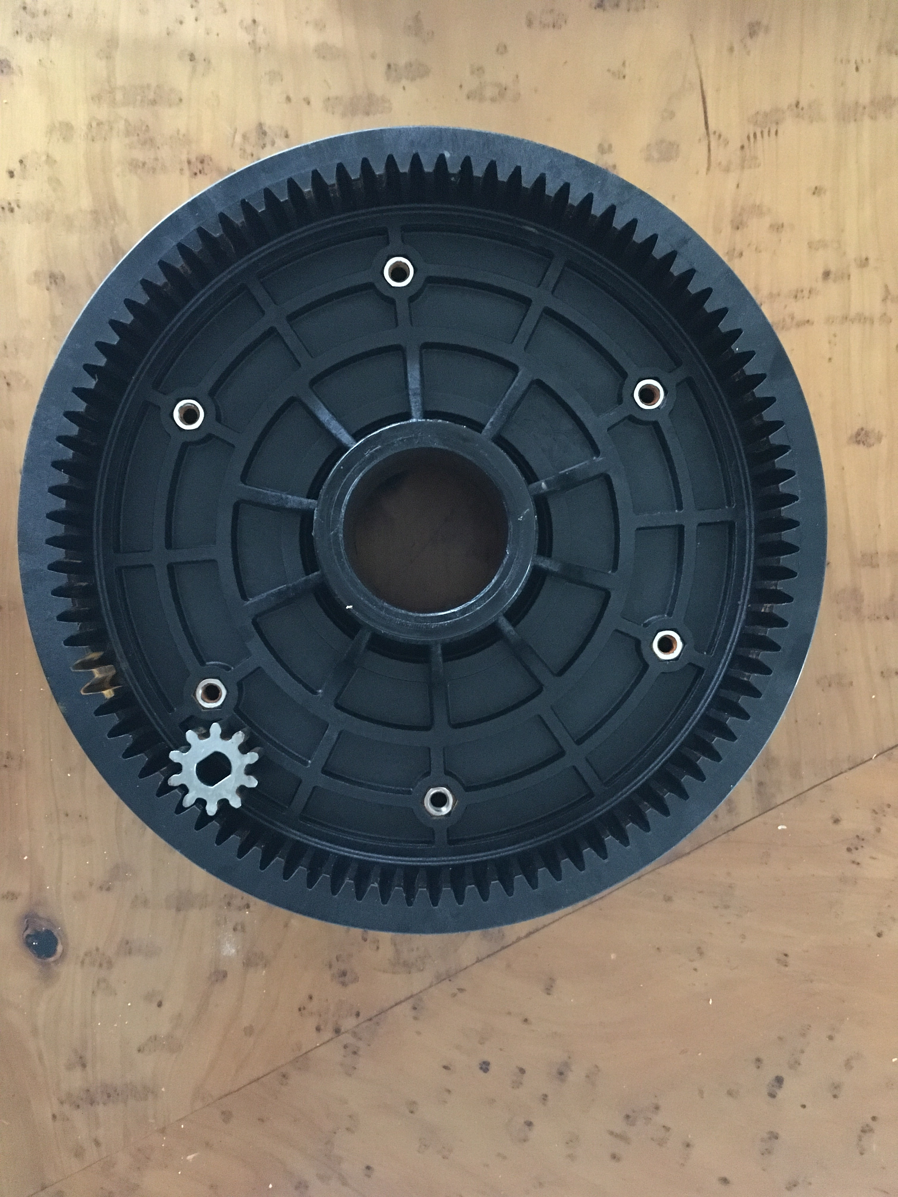

Gearing does sound like a better solution. And this is probably a mechanics question rather than one for the electronics forum, but this is the existing gearing mechanism. I'm struggling to see how I could further reduce this without moving the motor (which I would prefer to avoid since it would mean reworking the mounting / housing).
The other option i was thinking about was a big torsion spring on the actual roller itself to balance the cover and therefore lessen the required torque of the motor... in much the same way garage roller doors are balanced.

Bit of a job to change the gearing, using a higher torque motor may require a larger supply transformer.
Pulleys and vee belts on the output. Or another gearset.
As you say, this is not a mechanical forum.
Look at what existing pool cover motors might use.
