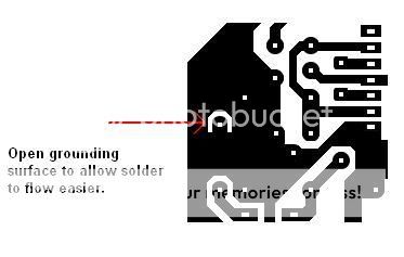

Additionally, be careful when placing a pad within a large ground plane.
Suggestion:
Trying to solder a component in the middle of a large ground plane can be difficult.
