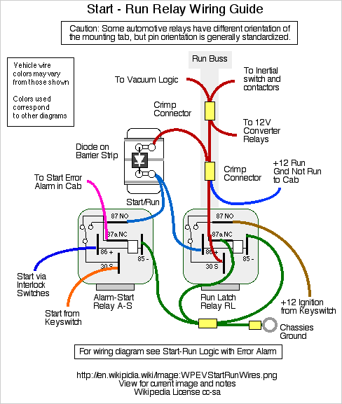

What you posted is a schematic. Here is what a wiring diagram looks like.
https://en.wikipedia.org/wiki/Wiring_diagram
