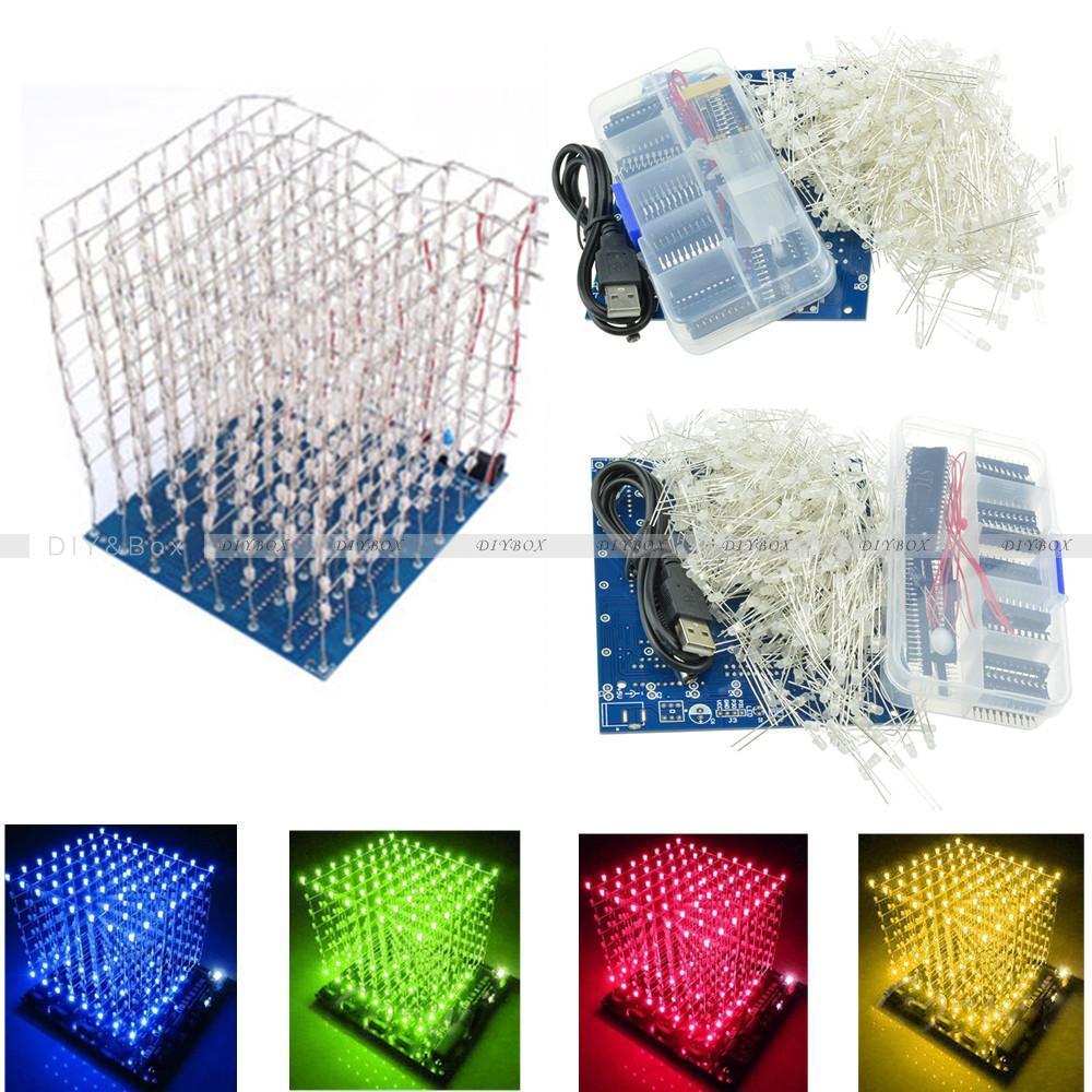

Start with a 3D LED Light Squared DIY Kit 8x8x8 3mm LED Cube White LED Blue/Green/Red/Yellow for $16.00, delivered to your front door. The LEDs do not change colour but they produce all sorts of different patterns and effects. You can select: blue, green red or yellow LEDs when you buy the kit.
Or you can buy your own LEDs and mix them.

I'd also recommend you read this:
http://www.instructables.com/id/Led-Cube-8x8x8/step1/Software-Effect-launcher/
Understand the complexity of a 1 bit 8x8x8 cube, and then contemplate that you are asking for a 24bit 8x8x8 cube.
Not only will the wiring be 3 times as complex (for the three colors) but you need to transfer 24 times the amount of information for each frame (1.5k vs 64 bytes)
