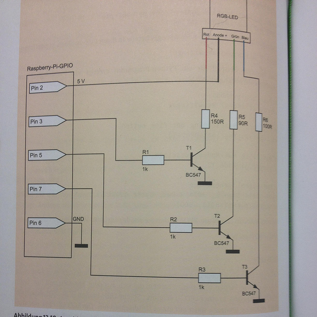

I am going to be using RGB leds for a project and I am wondering if I can use variable resistors (VR) to control the color... so red led would have a VR blue would have one and so would green... I do not want to use electronics I want to use knobs that I can turn to change the color... this is a rough schematic of what I want... but I do not know if that will control color or not I could not find anything only everything I found people were using microcontrollers... A schematic would be great if this is possible but I am doing it wrong... The reason I feel this is wrong is because I am controlling brightness of each led so it may change the color but it could end up being super bright or super dim depending on the color... so basically on my RGB keyboard I can change color and brightness so I think I am missing control over one of these... now what I think if I put a VR between the fuse and the first branch to the fist VR that would control brightness maybe but I am unsure as well as battery size and minimum VR resistance like 1 ohm to 100 ohms or whatever is best for RGB leds... any help is appreciated...View attachment 28593
Select the resistor to set maximum current and brightness level. If V LED is 2 V and +V is 5 V, when the pot is set to minimum resistance the resistor has 3 V. At 20 mA the resistor should be 150 Ohms.
The pot will set minimum brightness. Maybe a 2,000 Ohm pot. So the full range of the pot takes you from minimum to maximum brightness. About 1 mA to 20 mA.

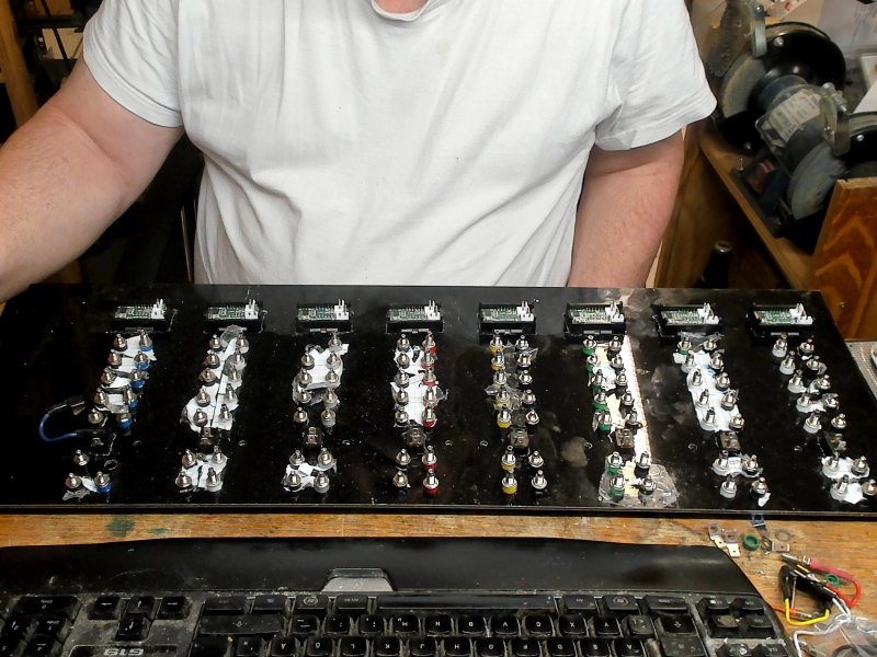

Hi everybody. Hope you had a great time over Christmas and my best wishes for all of you in 2019.
Wishing to get ahead with my project of implementing what I call 3rd generation panel:
It is a panel that offers me ways to connect my experiments to a choice of voltages. To the right of the first 4 columns, you can guess there to be a hole, 5 mm diameter next to the switch, same to the left of the switch in those 4 columns. My goal is to have 5 mm diameter RGB LED that shines in the color of the corresponding column. I still have to color some using Revell colors.
The voltages for the columns right to left are:
+24 VDC
+12 VDC
+ 5 VDC
+ 3.3 VDC
- 5 VDC
-12 VDC
The most right column is reserved i.e. to connect the battery pack I am making for my sailboat model,
12 LiFePO4 batteries connected in series which means the voltage will be between approx. +40 VDC and +24 VDC, depending if the batteries are full or unloaded to the tolerable minimum.
The circuitry I am planning to develop starts from the above-shown circuitry to feed RGB LEDs. The RGB LED I did purchase has a common cathode pin. As I am going to have 8 RGB LED in my panel this means I will have to feed 8 x 3 = 24 PWM to define the color in which each LED shines. As the Raspi ZERO W has a too limited number of pins to supply 24 PWM I am using 2 of this PCA9685 board were each of the can generate 16 PWM locally:
Here a picture of the rear of the panel front:
Until I found out that my RGB LED do not have a common anode but a common cathode pin and trying to see what devices would be proper to handle the RGB connections taking into account that a supply voltage of +24 VDC and up to +40VDC would require resistors of pretty high power. The 1/4 W SMD resistors would be OK for the lower voltages, but not for those 2 higher supply voltages.
I had planned to follow the circuitry above but replacing the 5 VDC shown there to come out of the Raspi by feeding the "positive pole" of the column. So I had planned to feed each of the RGB LED by connecting it to the receptacles above the switch. So the switch in the "ON" position, receptacles above the switch get their positive connected to the power source and the RGB LED is powered. Switching the switch to the "OFF" position and the RGB LED would be OFF.
Now my questions:
1. How does the circuitry change from the above-shown drawing?
Is it that I do have to connect GND to the cathode pin of the RGB LED and replace the GND connections in the drawing of the BC547 with the "Positive pole?
Or would I have to use PNP transistors in replacement for the BC547?

1.
That's the way:
2.
I suggest you do not use the various voltages to directly power the LEDs. Use the 3.3 V or 5 V supply as "VLED" (see my schematic). Use the control pin to turn an LED on or off.
As for the pwm: usually pwm is used to control the brightness of LEDs in a quasi-analog manner (dimming). I do not see why this should be necessary here. Your panel shows 5 different colors

The RGB LEDs have to get OFF when the corresponding switch is OFF. That is my justification to feed each RGB LED using the positive pole taking it from the positive pole circuit above the switch. I want to be able to control the color of each RGB LED from a window on my W10 Pro desktop. So by having the controls for the individual 24 PWMs in that window, I can control color and intensity.
The colors of the voltage receptacles will be different for all 8 voltages that will be available. I just have been too lazy to color all the corresponding plastic elements of the receptacles.
@harald: Having to take the "positive poles" I need 2 slightly different for "positive" poles and for those of negative voltages. The other aspect is those feeding voltages of +24 VDC and +24 VDC to 40 VDC means that the resistors have to burn a lot of energy. Here I plan to use switching voltage regulators that make available + 5 VDC. Then I can use the resistors of 1/4 W SMD versions.
But nevertheless thanks.
As far as I can see you turn the voltages on and off using mechanical switches. If you use double pole double throw switches, you can use one pole to turn the output voltage on and off and the second pole to control the LED - completely independent from the voltage that is switched.

Sorry for being so bad to make me understood. @Harald: The LED has to switch ON/OFF by the switch to indicate that the receptacles above the switch re either ON or OFF.
That's exactly what my proposal does. Use one pole of the switch to turn the power on or off, use the second pole to turn the indicator LED on or off. You can control hue and brightness of the respective LED by selecting the appropriate series resistors.
