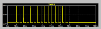

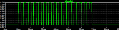

As a first try  the circuit below  has a transformer with the primary of 1.8mh and 0.1 ohm while the secondary is 720mh and 150 ohms. The inductance is related to the number of turns squared ratio: 25^2 to 500^2 =  625/250000 =    0.0025 thus ( 0.0025  *  720mh) = 1.8mh  So your guess is a lot better than mine would be.
For input the pulses are 2ms on and 2ms off for a period of 4ms. Amplitude is 8 volts.
The out put would make a good TENs device for an elephant.

In the simulator (with 100 ohms between the PSU and the coil and 1 ohm resistor in the source lead of the ITF840) the output is about 1.2kv peak with or without the 1.164 meg  resistor. With the 1.058nF capacitor it drops to about 750v and with the 5.18nF it drops to about 450v. The current through the secondary coil is +29ma to -42ma peaks.
The current through the primary is 0 to 1.8 amperes peak.  This is with a 100 ohm resistor between the PSU and the coil.
At the 1 ohm resistor in the source lead  of the ITF840 it shows  1 ampere peaks. I found an ITF840 spice model.
If you put a small resistor in the source lead of the IFR840 you could measure the voltage across it and see if the current is what you expect.

I would think you are not hitting it with enough current. Using a resistor instead of the IRF530 as it is faster to use rather then dorking around with two resistors to simulate a pot. I am using a input pulses that 2.5 ms  on and 2.5 ms off at 6.8 volts peak
No bifilar coil nor diode in the output:
  • resistor      current    output capacitor  output resistor   output voltage
  • 100              1A          1.058 nf               1.16 meg            720 volts
  • 100              1A            0                        1.16                  1.05 kv
  •  50               2A           1.058 nf.              1.16                 1.0 kv
  •  50               2A            0                         1.16                  1.2 kv
The current being a  symmetrical pulse(?) would be  only be half of a continuous draw from the power supply.

I was using the fixed resistors as the simulator dos not have a concept of a potentiometer. Putting the 530 back in an using a combination of two resistors  between 30k - 17k to 46k -  1k (where the lower value is to ground) I get good results with 40k - 7k  and 30k - 17k but the peak current is 2 amperes for  some reason.  At 44k - 3k the current  is 900ma but the output is down to 50v. I will continue looking at it.
If you have a symmetrical  pulse waveform say of 1 ampere I gather the rms value of the current is 1 * 0.707   and the rms voltage would be 100 * 0.707 so the equivalent power would be: 0.707 * 70.7 = 49.98 watts  not the 100v * 1a = 100 watts of a continuous drain. So one may be able to run it above 1 ampere.
