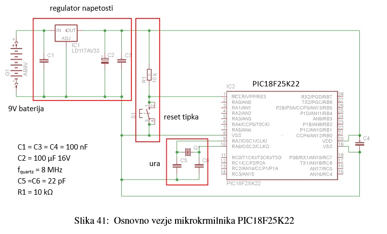

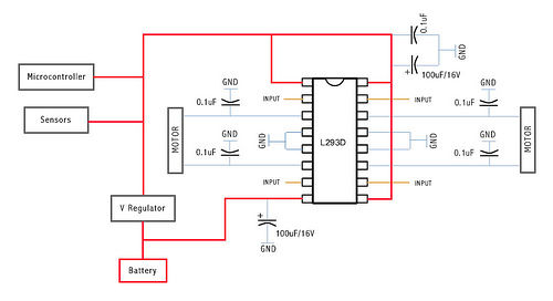

Ok. These are the two circuits that I currently have on my protoboard: The first one is the H-bridge
and the second one is the basic PIC micro controller circuit.
So now I need to know how to connect the two circuits. You already stated that I need to connect the + and GND wires of the servo to the H-bridge. There are also 4 inputs on the H-bridge, how/where do I connect those? And then, how do I control the speed/direction of my servos?

Hello
Here is the datasheet and it gives you the logic table for one driver. For your application you need to have it set up so that one of the drivers output is high and the other is low. The motor will go in one direction. If you were to reverse the outputs of the drivers the motor will rotate in the opposite direction. The data sheet shows diodes across the motor for flyback voltage suppression. I would include these in your design.

TY for the quick response. So if I understand correctly, I have to connect the bridge to any two ports of the micro controller, which are able to give a high or a low output, and I simply steer the motors by appointing a logical one or a logical zero on the two ports, following the truth table which is in the datasheet? And thus I can only steer the two modified servos with one speed in both directions?

I don't know if you can put PWM through this chip. But you could try and PWM the output pin you would be putting high.

My mentor mentioned using PWM, so I thought that's the way to run the servos. I also found some literature on the web that used PWM on the enable pins of the H-bridge but have struggled to understand why and how. So now I'm a little bit confused. Yes, the output of the PIC might be controlled with a PWM and thus controlling the motor speed. But what about the truth table then? There are two enable pins on the bridge and they need to be set to high or low in order for the servos to work one way or the other. The right combination then decides if the servo stops, goes clockwise or counter-clockwise. But how would I use the PWM then..?

I think from what you just said by using the enable pin to turn the motor on and off will work I have never used this device but can't see why that won't work. So you set one input pin high and one input pin low for the direction you want and then PWM the enable pin.
