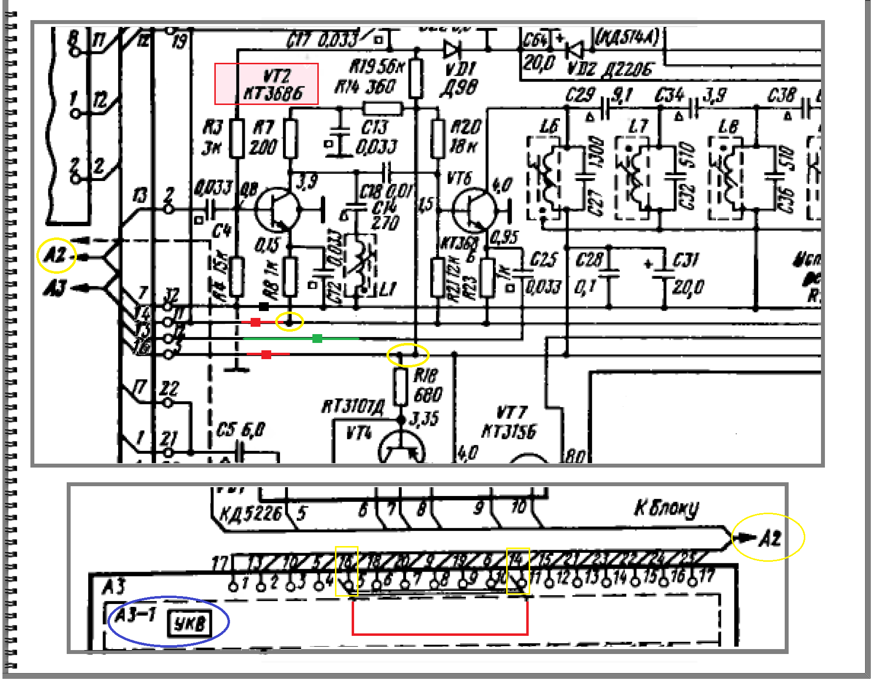

Check out the supplied referencing and note that the bottom section is being a schema clip of the radio band switching.
On that A3 board, the pressing of the yKB . . .Tape . . .has the RED connection opened between the 14 and 16 switching contacts. The wiring from them is routed over in the A2 wiring loom and ends up at the top schema clip at the A2 loom, to then break out and be the two RED lines that I have highlighted and RED blocked.
The very top path is a BLACK ground buss the RED one below it should have supply voltage on it as well as the other RED one below. The GREEN one is an RF signal buss.
The YELLOW circled R8 lead and the R18 resistors should provide contact / metering connections.
Now, how about having a no power condition and meter those two connections in low ohms mode and confirm if the TAPE-to Radio pushbutton activations doesn’t show a short . . . in radio mode . . . and open in tape position.
If so confirmed, a temporary wire jumper between those points should maintain power to the radio section while being switched into tape mode.
REFERENCE . . . SWITCHING:

When I first made this thread , you posted a image highliting the flow of the audio from the deck
Very good representation but I noticed a mistake :

Now , let's go to the recent mistake :
You assumed that YKB means tape ... Lets see what radio bands can this radio cassette receive :

You see that YKB = FM band .
