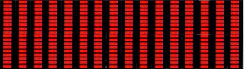

I want the frequencies coming from 3.5 jack not mic but thanks for the fantastic responce also how do you set
set max amplitude to 5V
Does that mean that the when at 5v then the 30 leds will light in each band?

so I think the code is fine, I should use the LM3914 and the pwm pins of the esp32 dev board (there are 16) each pin to represent a column and band width and set the max signal of the LM3914to 5V so that means that when the signal is at 5v, all the LED's in that column would lit. so I have this code and it compiled fine for the esp32 dev board and I'm not using WS2812B LED strip, I am using bar graph type LED's, can you help me modify the code for my needs and explain please!? with 16 columns and 20 rows (instead of 30) thats 320 LED's! but I need the bar graph type because I want a certain "look", thank you! also I can change the amplitude to make the columbs go up to the desired 20 LED's
So I would set LM3914 for 5V all LEDs on.
So thats max V we want out of filter
20 leds will light in each band? when the pwm signal is 5v
danadak
Feb 19, 2021
1,104
Feb 19, 2021
1,104
Signal chain, mic >> filter >> LM3914 is the signal chain

ok thanks I would be using 3.5 jack >> filter >> LM3914 can you explain step one and I can work it out from there I think?, do you think that it's a good idea to control LM3914's columns with PWM from and esp32, if so how do you think I should go about it? the filters are omitted if I use that idea of using the FFT malarky and the esp32 I think that is the way to go personally just need to mesh it in with the arduino code, ie having the bands activate the different PWM pins, one pin for each column
