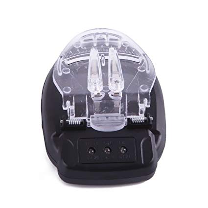

Charge the battery using another S5 from a friend or request the dealer to charge your battery so that you can do a backup. Don't know about your place, but here, in India, its possible to buy a Universal Cell Phone Charger for about $4. Looks like...
eBay and Amazon seem to have it.
