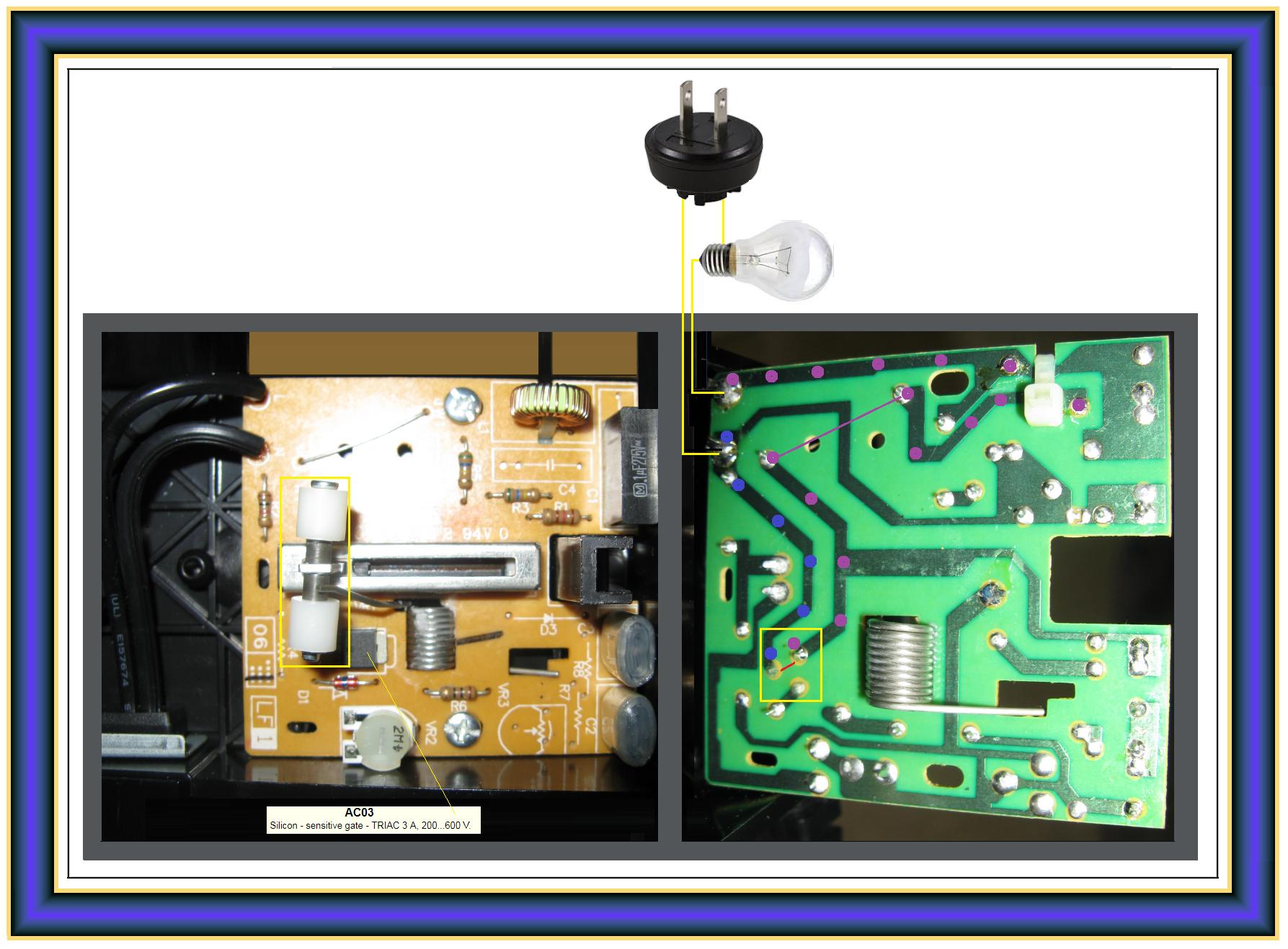

I have a used electronic speed controller(model N) from a brother sewing machine. Input voltage to controller is 120V but output voltage is nada, zip, zero. Does not matter if pressed to floor or not, still no voltage. I'm a nob at electronics but good at replacing components if problem(s) can be discovered. I do have a simple capacitor tester and all three tested ok within specs. Attached are pics of board. If someone could enlighten me as to further multi-meter tests to try I'd be eternally grateful

Correction, there is no voltage going to the board, only voltage coming from mains. I have continuity from pin 2 to neutral on board and continuity from pin 3 to line on board but voltage does not register either on pins 2 or 3 or on board solder points of line and neutral. Not sure what this means. Maybe cord is bad, maybe other board component? By pins 1,2,3, I mean the cord(see picture)

Wondering if I need to place a load on pins 2 and 3 somehow, then test voltage? Forgot to mention that I no longer have the machine. I just want to know if speed controler is working.

You could try putting a test lamp on the load.(normal 120v tungsten bulb, say around 60W)

No fuses to be found on this cheap board (looks to me as though they bypassed what was supposed to be a fuse and just put a wire across it?). i don't have a tungsten lamp - can i use 60 watt incandescent instead? (remember i'm a electronics knob :-(
I unscrewed the board and added a pic of back side of board. Do these types of speed controllers need a load to receive power from the mains, or could I have a component failure?
That is a tungsten (filament) lamp.
The most likely component on that board to fail is the semiconductor device (arrowed) :-

Sir whiteoutage . . . . .
Just two wires are being involved with the dimmer power control path in the submited explanation.
HOT AC line power comes down and passes thru the lamp then passes down into the dimmer as the PURPLE DOT path unitil it reaches the TRIAC power controller YELLOW RECTANGLE.
Other photo
As the foot switch rollers move to the right the speed / lamp intensity should increase.
First photo
The returm power path is made via the BLUE DOT path.
If no control, your placing of a jumper wire across the triac terminals marked with the RED bar should give full lamp brightness if there are no wiring problems.
If not . . . expect the need of replacement of previously mentioned YELLOW RECTANGLE triac . . a la . .most honnable . ..alex_teeeeeeeeeeeeeeee.
