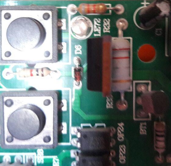

hello friends
i need Limit Current to 2A Like This circuit
When the current through 2A RED LED ON .
Please help to get the circuit diagram .
Thanks

Why don't you just use that circuit? Otherwise we need wayyyyy more information. What is the load you are driving, what voltage, that sort of thing.

Voltage = 24V
Load= Seven numbers external 7segment
i need current limit like this circuit Very simple with a LED display

Do you need constant current or a current limiter. Very different things.

But i want the circuit schematic in image
Who can help me

How large is the heat sink on your TIP122 considering it may dissipate 48W?

I realized
This is not limiting 2A
I can not test this circuit Because is working
Do you think that how many watts?
can help to find the diagram?

I can guarantee that is the number of watts if your TIP122 is driving 2A into a short from a supply at 24V.
The heat sink will likely be about half the size of your fist.
If this is really what you want, I can point you to a circuit (in fact, you may be able to find one similar in the LED resource on this site)
If I said you had to calculate a resistor which would drop 0.7V at 2A, could you do that?

I have think that each segment will take 30 mA
Seven segment was a 210 mA current I have 8 Seven Segment result 1680 mA
and a current limiting 2A need
So how do the Chinese Limit the current with TIP122 without cooling ?
Possible short circuit too much
But at the time of short circuit LED short circuit on the field and we realized getting short-circuited

What is the TIP122 doing? In a multiplexed display it will either be driving a max of 30mA or 240mA depending if it is a row or column driver. In either case it shouldn't be shorted out and if it is, you've done something badly wrong.
Is it a LED display? If so, why the 24V supply?

this is elevator 7 segment display and we have 8 floor and 8 7 segment too .
In step installing Possible short circuit too much (24V With a,b,c,d,e,f,g) and when +24 connected to a(7segment sc) one LED in Circuit on and we realized getting short-circuited .
i need a circuit limit current to 2A have Signal LED TOO :)

I don't understand.
Are you driving 8 x 8 digit 7 segment displays?
Is the TIP122 the driver for the segments or for the digits?
Remember that in a multiplexed display only a single digit is on at any time. The digits are scanned through quickly to give the illusion that all are on.
