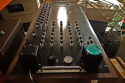

heres an rc system which chain reacts across. it would work for what u want, except the problem
is it needs not be an input pulse, it needs to be solid power going in, then it delays on at the end of the chain.

Thank you Dragon. Not EXACTLY what I need, but still useful
