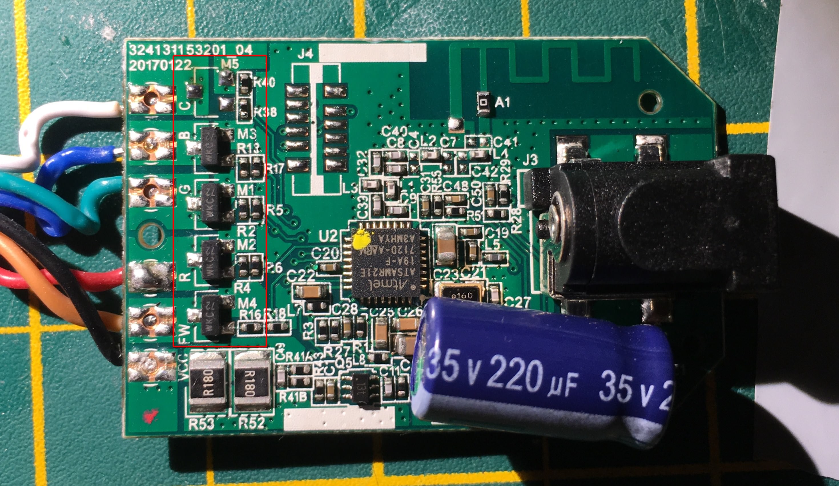

I've identified a failed SMD transistor (shorted) on an LED light strip controller PCB. The transistor outputs directly to the LED strip. There are 5 on the board, one for each colour channel (one removed in photo for testing).
The board runs on 24v from a CV 0.83A 20W power supply.
I'm pretty sure the component is a SOT-23 package. Length and width seem about right.

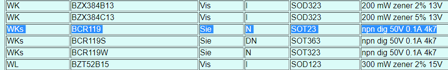

The markings on the component are WKC 72. I'm not quite sure which part of the marking is significant. I used this codebook as a reference. Initially I thought the WKC was the important part. This lead me to BCR119
However I'm not sure if this is right. If the 72 is the important part, then it could be 2N7002
The silkscreen designates the component with an M. MOSFET? I'm thinking the 2N7002 is most likely correct. Am I correct in my assumption?
Looking at octopart, they come in a variety of continuous drain currents, from 115mA to 1.4A. What would be a safe choice for my application?

Any n-channel SOT23 mosfet rated a fair amount over the single LED strand drive current, which I don't know (but you could measure, but don't really need to) so above the PSU 0.83A. They come in much higher currents than 1.4A but that should work.
your logic doesn't follow
the chip as you stated has WKC but you found/hilited WKs which is likely to be a totally different device
you need to look for WKC
The 72 will be a manufacturing date/other info not directly related to the part type
