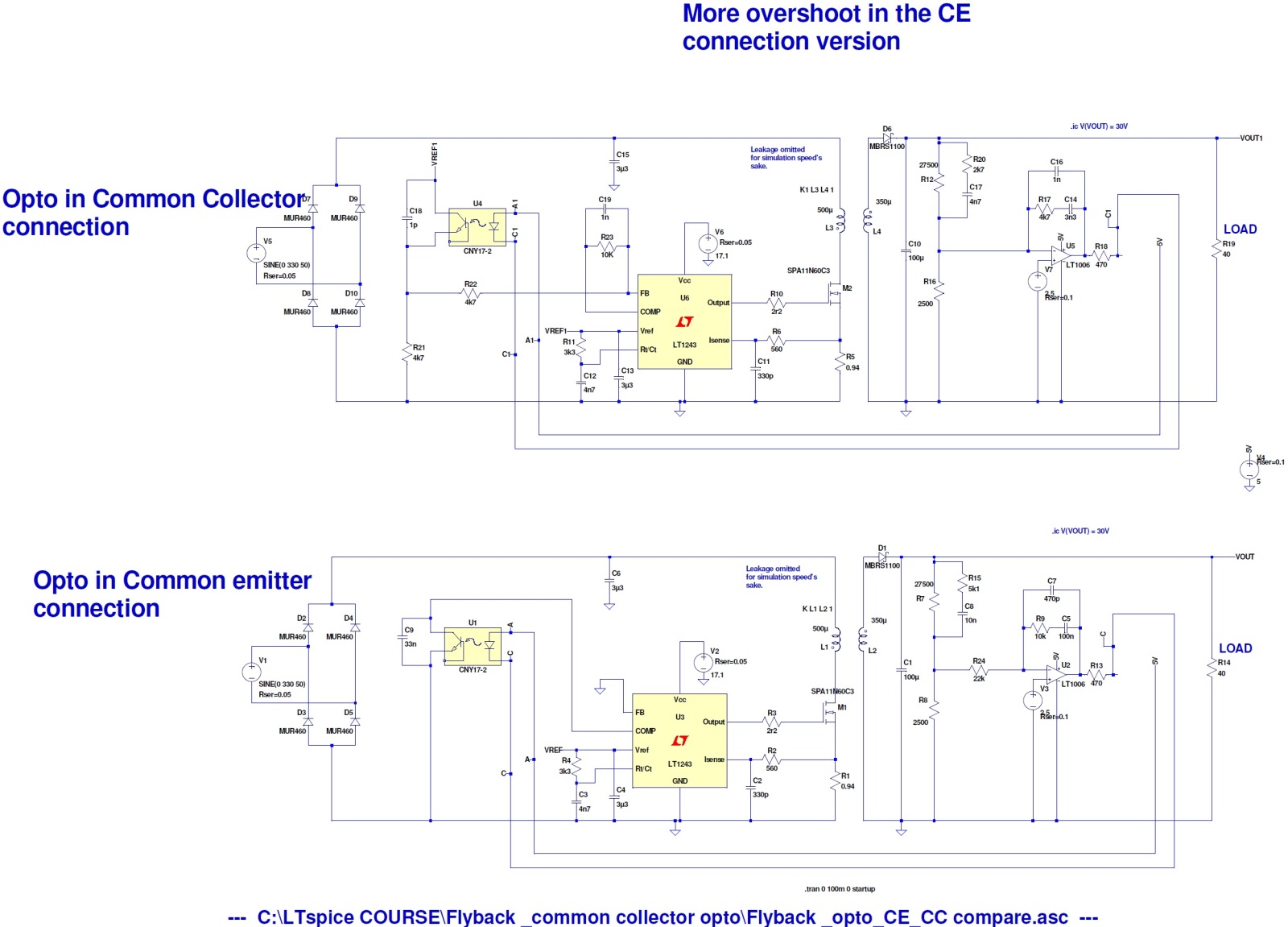

Please Note these two equivalent offline flyback simulations.
-one has cascoded opto feedback , and the other does not.
Note how the non-cascode version has 2V of overshoot on vout at start-up. Due to the lack of a cascode, this overshoot is virtually impossible to get rid of whilst keeping sufficient gain and phase margin. The casc0ded version has no overshoot, and achieving this was simple.
Cascodeing is extremely cheap to do...why does everyone not do it?
Schematics and LTspice simulations of offline flybacks attached. (one cascode and one no-cascode, but they are the same power level, vin, vout, np/ns, Fsw.)

the cascode is slightly more expensive, but a sot23 bjt and a few resistors is a small price to pay for a more robust power supply.
Is the cascoding of the opto feedback no different to using a common collector connection of the opto transistor?
Common collector connection attached, as well as its LT spice simulation
(Comon emitter connection of opto also attached for good measure)

Thanks, I believe that if we can find an answer to this question then it is amazing, because this is not written anywhere, even the Basso book doesn't cover it. (Basso pgs 288-308 covers these connection methods, but doesn't say which is more conducive to achieving stability)
You can see the opto transistor and see its either in CC or CE....the "VREF1" and "VREF" nodes are a 5V rail, provided by the LT1243 controller.
The schematic and simulation attached, show the differences in the optocoupler connection being either common emitter or common collector
here is the schematic in JPEG
..It is also attached in pdf
Here is the question again....
Regarding opto-isolated flyback SMPS’s, which opto-coupler connection method is more conducive to facilitating a higher bandwidth in the feedback loop whilst maintaining stability?….is it the "common emitter" connection of the opto, or the "common collecter" connection?
An LTspice simulation showing both connection methods is attached. In the simulator, the “common emitter" connection” version is far harder to make stable.
LT1243 datasheet...(its basically same as UC3843)
http://cds.linear.com/docs/en/datasheet/1241fa.pdf

There is no common emitter or common collector in anything you have shown.
edit: ask yourself "what is it common with"?
eem2am
Aug 3, 2009
429
Aug 3, 2009
429
"VREF" and "VREF1" are the supply rail provided by the LT1243.... this is what they are commoned with.
Its the opto transistor, inside the CNY17 optocoupler that is connected either CC or CE.
Pages 16, 17 18 of the following state that common collector is better...
..it states how "The common-collector configuration eliminates the miller
effect of the output transistor’s collector-to-base capacitance"
and generally increases achievable loop bandwidth.
http://cds.linear.com/docs/en/datasheet/4430fc.pdf

How can a transistor whose base is not connected to anything be said to be operated in common emitter or emitter follower configuration?

Someone has to explain to me how common emitter and common collector can apply to an optocoupler where there is no common connection (or more obviously, no connection to the base).
To my mind, the transistor will behave *exactly* the same whether the emitter is grounded and there is a load resistor connected to the collector or vice versa. What is happening at the base emitter junction is completely independent of the potential at the emitter.
Sure, an emitter follower has a gain of less than 1, but that requires that the output affects the emitter potential with respect to the base. That's simply not happening here.
The only difference will be that one configuration will have a faster rise time and the other a faster fall time. But this is simply because turning on the transistor causes a rise in one configuration and a fall in the other.
There may be other differences if there is a significant load on the output, and whether this is a source or sink, but then the differences are not due to the configuration but to the load.
This suggests that miller capacitance is a minor factor (bottom of page 1), and also suggests that you need a base resistor (so that you really do have a common emitter or common collector configuration) to be able to manipulate things to deal with this effect.
Without the base resistor, all you're doing is observing the effect of junction capacitance on switching speed and observing that you can switch on faster than you can switch off.
From page 10:
Another limitation of the Miller effect is that it only really becomes apparent when the turn-off mechanism is by means of an active discharge through a base to ground capacitor. In the case where the base is left virtually without any discharge path, the effects of “Miller the killer” are not noticeable...
I would encourage you to read page 7 which indicates that a base resistor is required should you wish to have anything other than a "common emitter"
The next step in switching speed improvement is to move from a standard 4 pin part to a standard 6 pin coupler. This type of coupler gives the user access to the base of the phototransistor and allows us to modify the standard common emitter switching circuit discussed above...
Maybe I'm missing something, and if I am, I'll be quite happy to be educated.
edit: and while I spend ages writing a tome, Kris gets to the point in one line.

If you connect up an Opto coupler correctly I am pretty sure you can have common emitter or common collector.
You can connect it with the emitter to 0V and the collector through a resistor to V+ or you can swap the transistor and the resistor over; this will determine whether the voltage goes high or low when the optocoupler is energised, but the transistor doesn't (can't possibly) behave any differently if the base isn't connected to anything!
It cannot meaningfully be described as either common emitter or emitter follower topology.

Consider Vce. Will that ever be different if a resistor is connected between emitter and ground vs collector and Vcc.
I suggest that with no connection to the base, the answer must be no. The only difference is a 180 degree phase shift and a level shift.
edit: Read section 2 of this: http://www.renesas.com/products/opto/technology/usage/index.jsp
Miller effect will play no part in differentiating the behaviour of an opto in "CC" or "CE" configuration.

That explains it nicely.
If a document refers to the collector output topology as "common emitter" and the emitter output topology as "common collector" or "emitter follower", it's because the author hasn't realised that those names they aren't appropriate, or the author is using them as (misleading) shorthand for collector output and emitter output, because they are easily recognised.
This will also be true when an external base-emitter resistor is used to speed up the turn-off of the phototransistor.

Yes Steve
I did mention the use of a resistor to speed up the device and you will then see a marked change in the response of the rise time between the two. Is phase shift correct how you have used it? Phase shift is a shift in time between two signals. Should this be signal inversion.
Regarding your link which part of it is not technically correct with regard to base current coming from the collector. This is incorrect, the base current comes from photons hitting the base collector junction causing a photo current (base current from light). Apart from having a base junction optimised for this purpose they are the same as normal BJTs. You can even cut the top of a 2N2222 and use this as a photo transistor.
With regards to CB CE and CC I think we will have to beg to differ on this. The way I look at the different configurations is which ever terminal of the transistor is not the input or output has to be the common one.
This is then quite simple to work out even if the text book diagrams that are used show negative voltages where you would normally see a positive voltages in normal conventional circuits. This is quite of the case in Physics books
This can be quite non intuitive at first glance and take some working out when we have been used to circuits being connected up the other way.
