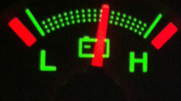

The multimeter is also connected by a hot wire to the negative terminal and a neutral wire to the positive terminal. This multimeter is used mainly to know when the battery is getting low so that a person can get to a solar charging station or back home, before the battery dies.
This battery gauge is used for the same purpose as the multimeter but doesn't show actual numbers or units.
Whether or not the battery needs recharged is dependent on the voltage but more important than that is the amperage. If the amps get too low, it doesn't matter what the voltage is, the battery needs recharged.
High amps but low voltage, recharge
High voltage but low amps, recharge
Low voltage and low amps, recharge
High voltage and high amps, doesn't need recharged
