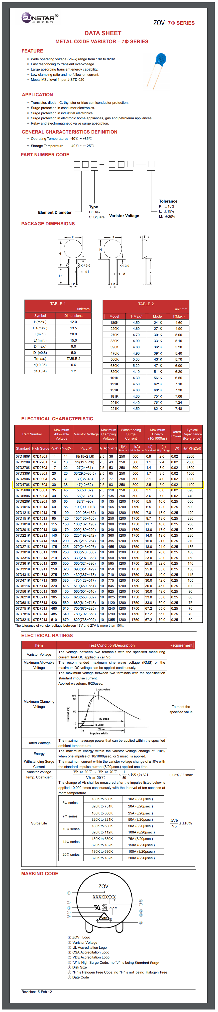

Sires . . . . .
Three cheers and praise be to our esteemed and honorable Debe for providing those critically needed numbers from a good varistor.
Now, along with the supplied data sheet . . . . all is now known.
Da Da Sheet . . . . .
Potentially time Limited Hot Link
https://i.ibb.co/jkpyQDd/Sintered-Zinc-Oxide-Varistors.png
