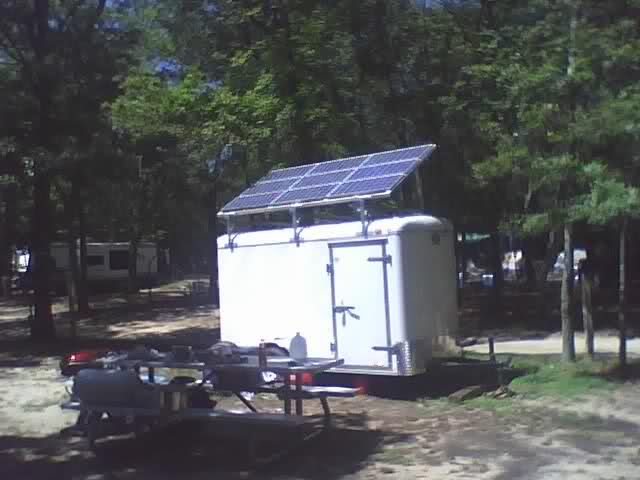

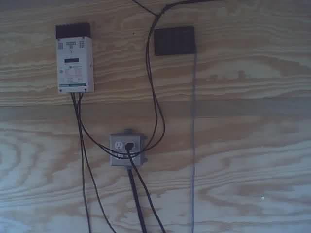

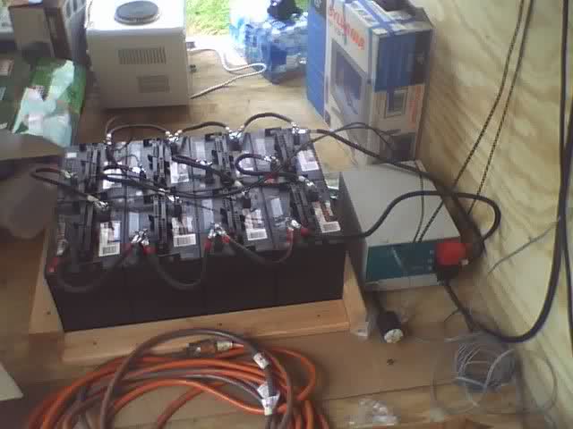

busdweller said:
Something like this may do it for you. I built this solar bungalow to
stay in when I have to go out of town for work. 9/51 watt panels, 8/6
volt golf cart batteries wired for 12 volts and a 1000 watt Xantrex
Freedom inverter/charger. It will power almost anything. It hinges on
both sides.
How much did all the parts cost ?
Graham
