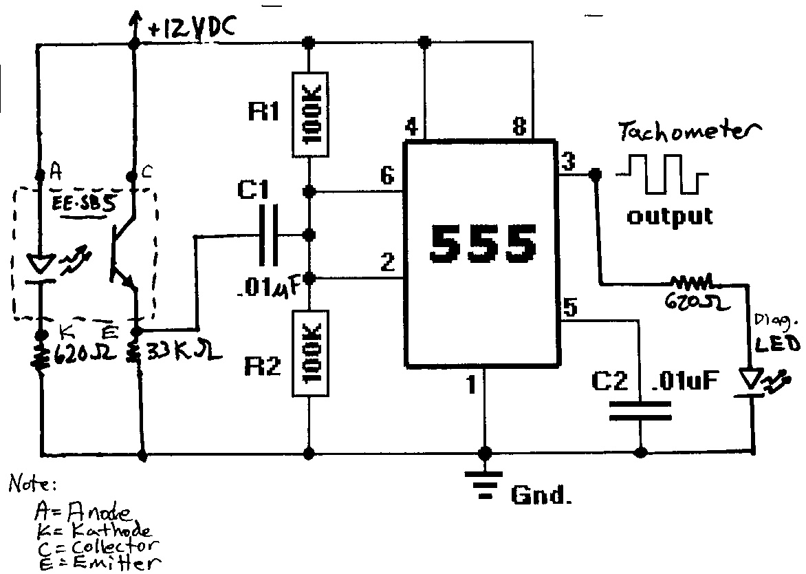

I'm need a help about a designing one, I hope, simple electronic circuit.
So... I will try to explain what should it be... I posted an image (i know it's poor, my english isn't far away from that too...  ) to understand what I mean.
So, the disk has four stripes on it, and the disk is spinning on AC motor with variable rotation speed. I need to count this stripes and show their number in one second.
I explained it this way (with stripes) because I belive it can be done with LED and phototransistor. So this looks like some kind of tachometer, just it shows number of 'stripes'/second. I was been looking on net for some tacho circuits, but i didn't find anything usefull. Yeah ... i forgot to tell: the result needed to be shown on LED display (LCD acceptable too... ;D).
I hope you know what I meaned... If someone has a idea or some circuit that can be used, please help...

Hi,
yes LED and phototransistor is ideal for this application, but if this disk is not very wide, you can use optocoupler with air gap, like a this in some PC mouse. If this disk is made from metal, steel or other magnetich material, also you can use the hall sensor.
For counting have different ways, use the onchip counter, or use uControler, Pic, AVR etc.
But .....i don't know what is the accuracy that you want. For example if you have 4 impulse per turn, and the speed is 3600 rpm this is a 60 turn per second, or 240 impulse per second. The resolution will be 3600/240 or 15 rpm. This is the +/ 0.41 %. But if your speed is low, 360 rpm for exampel this is a 6 turn per second or 24 impulse per seconds, then the resolution is 360/24,again 15 rpm, but this is +/- 4.1 %.

Hi, thanks for jumping in...  :)
Well... The disk would be made from plastic, and it would be something around 15 cm wide, and more maybe.
Counting: I would like that circuit be as simple as possible - without uControlers and need for programing them. Just a sensor, counter and LED display driver. But OK, I will understand if that will not be possible.
Speed of motor is high. But, its a variable, and I actually belive that minimum will be somewhere on 1800 rpm. (120 impulses/sec)
Of course, I would like accuracy to be as high as possible, but +/- 5% won't bother me to much...

Hi,
OK, in this case +/- 5% you can use counter mode, because if you want high precision you must measure impulse time, and for this some suitable is uControler, but in your case this is unnecessary.
You can use something like a ICM7226.
For sensor, in this case using of reflective sensors is a most suitable, because 15 sm is the long distance, and have a big possibility to wrong detection.

Hi,
the ICM7226 is the most simple decisiaon, this or somethin like this chip. The next possibility is to use the uControler, in the web yu can find many diagram with PIC 16F84. But for this you must have programer etc.
Another way is to use frquency to voltage converter, and use the standad module wit ICL7106 or some equalent, but this is i thin is not a more simple. You can bay the frefuqncy meter modul and use it.
But i can't understand were is the problem ith 7226, the circuit is a very easy to use, you wil need only several external component. No need to use all 8 LED, you can use only 4.
To realize this with the standart logic will be more expensive, and will need to use no less that 6 IC if use counter with a LED output, or 13 IC if use standart counter and binary to 7 segment decoder.

Hi,
you need a frequency meter mode, with 1 Hz time for measuring.
See the attached file, only i'm not suare how must set the channel, if may be you can connect to input together, to be sure that every time will measure the signal.
And .... im not suare if the chip have a current limit for the LED, if not have internal limitation you must put external resistor on a,b,c.....g wire, around 200 Om.
The good idea is to use comparator for the input signal, with hysteresis.

Hi,
yes you can use 555 or something other chip, actually 55 may be not a very suitable for this application. I know that exist, but never not use a on chip converter, this is small chip that convert frequency to voltag.
Ok i will see for some good analog decision that is not a very expensive. Why you dont want to use a microcontroller ? Will be very easy and simple :)
I will try to make this schem for you in the next several days, if have some free time today or tomorrow.
Edit You can find the LM2917 chip in your country?

So why not download the datasheet for the LM2917 and use one of the tachometer circuits it shows?

Perhaps this will help:
http://www.shumatech.com/dro-350/add-ons.htm
or this:
http://electronickits.com/kit/complete/meas/vek2625.pdf
or here:
http://www.4crawler.com/Diesel/CheapTricks/Tachometer/index.shtml
or a combination of them.
Hope this helps.
MP

Hello again...
Well, MP && Audioguru, i realy appreciate your efforts... Thank you...
So, simpliest possibile solutions seems like this one posted bellow (from datasheet ... thx audioguru), and this one at
(thx MP...)
Which one do you reccomend to use and what modifications should I make to use them for my application?

They are different types and either will work. In looking at your application, perhaps you will know if one setup is better than the other for your particular application. One uses a light beam with a chopper wheel to count pulses and the other uses magnetism and a reluctor to count pulses.
I think the light chopper with 555 would be the least expensive.
MP
