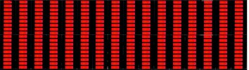

I am planning on having a 24 x 20 LED matrix that have common cathodes along the rows, and common anodes up the columns each column has to refresh 25 times a second, multiply by 24 (because of the columns) that equals 600 pulses a second, the time that each column is on is 1 second/600 pulses that equals 1.67milliseconds. so each column is on for 1.67milliseconds as it progresses through the frequencies it steps to the next column in 1.67milliseconds.
41.5Hz, 53.8Hz, 69.8Hz, 90.5Hz, 117Hz, 151Hz, 196Hz, 253Hz, 328Hz, 424Hz, 549Hz, 710Hz, 917Hz, 1186Hz, 1532Hz, 1980Hz, 2559Hz, 3306Hz, 4265Hz, 5489Hz, 7050Hz, 9032Hz, 11631Hz, 14955Hz
I want the amplitude of the frequencies correspond to decibels, (3 decibels per LED's upwards) and I want the amplitudes to also correspond to the columns. And so for instance, when the column is at the 7th column (ie 196Hz) I want the amplitude for that frequency corresponds to the right column that is on at the time, so when say column 7 is on it might have an 18 decibel, so 6 LED's would be lit, then when it clicks over to column 8 that might have decibel of 6, (two LED's illuminated) and when it clicks over to column 9, that might have 22 decibels (it would light up seven LED's) how do I keep the amplitudes in sync with the columns? I have 1.67 milliseconds to process the sound frequency and to display it on the matrix how can I achieve this? any idea's welcomed and I will answer all questions to the best of my ability. I believe I have to utilise 74HC595 shift register to accomodate the 24 channels and I think I can use the rows to directly go through transistors to the the pins of the esp32 arduino.
I am not certain and am open to idea's I hope someone can understand the question. Can I maybe have a different method of doing this? or help me work with the method that I have come up with, I can't shift on the type of LED's that I'm using because I'm going for a certain "look" the leds are of the bar graph type with 10 flat LED's in each bar.
Maglatron
Jul 12, 2023
2,025
Jul 12, 2023
2,025
Does anybody have any new ideas of how to achive this? thank you

so I think the code is fine, I should use the LM3914 and the pwm pins of the esp32 dev board (there are 16) each pin to represent a column and band width and set the max signal of the LM3914to 5V so that means that when the signal is at 5v, all the LED's in that column would lit. so I have this code and it compiled fine for the esp32 dev board and I'm not using WS2812B LED strip, I am using bar graph type LED's, can you help me modify the code for my needs and explain please!? with 16 columns and 20 rows (instead of 30) thats 320 LED's! but I need the bar graph type because I want a certain "look", thank you! also I can change the amplitude to make the columbs go up to the desired 20 LED's this is the actual size of the LED matrix that I'll be using
A quirky way to go about it:
  1. First you digitize an analog signal.
  2. Second you output the digital values as a (quasi-)analog signal using pwm.
  3. Third you digitize the analog signal using the LM3914 to digitize the analog signal for display.
Personally, my approach would be to use e.g. shift registers:
  1. Output the digital data from the microcontroller into the shift registers. You ned 1 clock pin and as many data pins as there are columns in your display (alternatively you could reduce the number of pins by multiplexing them).
  2. Drive the LEDs from the shift register's outputs (with the appropriate series resistors, of course).
But naturally it is entirely up to you how to do this.
