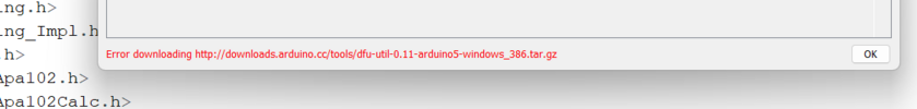

not sure il work it out again does anybody have a .zip file for the esp32 because my internet does not allow me to download and add

I run it and then it flashes up with a black cmd box momentarily
